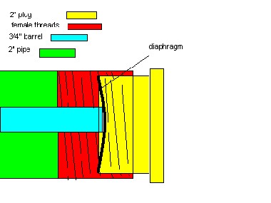

you can do it without a lathe. all my valves have been made without a lathe. mold a piston out of epoxy or hot glue sticks. it works very well.
all you need is a
(1) a tee to put it in.
(2) a bushing
(3) pipe for the outlet
(4) female adaptor
(5) male plug
(6) exhaust of some sort (Ball valve, QEV, sprinkler valve ect.)
(7) and lets not forget the piston
and you have yourself a piston valve
take a look at my piston cannon. its incredible simple and uses a 3/4'' end cap wrapped in tape as a piston.
http://www.spudfiles.com/forums/little- ... t7570.html
ps- one thing that helped me imagine how a piston valve worked is to think of it like you are building a coaxial cannon into a tee. that really is what wou are doing, you are building a coaxial into a tee. so my advise is look at coaxials first, understand them, then look at piston valves, you will notice they are the same.

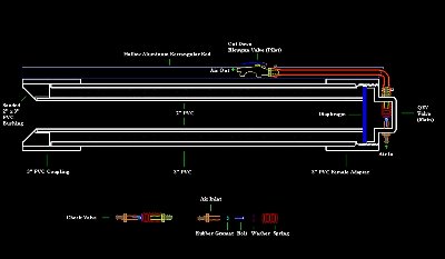

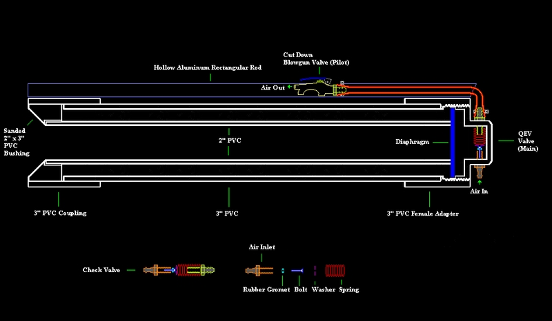

This may help.......if you know how they work then they are a lot easier to make (right)
