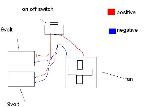

sorry but how would i wire two 9v batteries together? Would i simply just do this
hi
Posts: 1619
no, thats called parallel wirering. it would work, but you would still have 9v. to get 18v you need to wire it in series, like this-

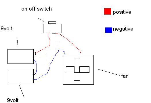

so more like this?
hi
Posts: 1619
yep, exactly like that.
