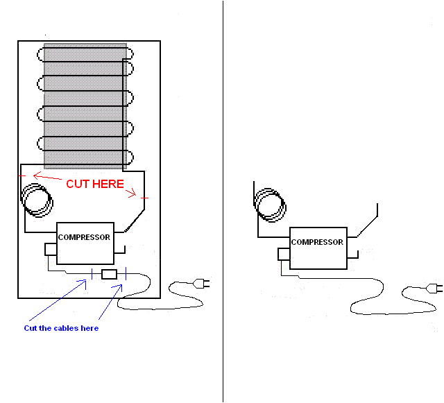

1. First of all, this thing is basically a part of a fridge - it is a pump that pumps freon gas (newer fridges use some more environment-friendly gas) through those small copper tubes on the back of any fridge.
2. There are several ways to find get this part: you can remove it yourself or you can buy it - they are sold as spare parts and I heard that some junk-yards have them.
3. To cut out the pump you have to cut those thin copper tubes ( cut about 15 - 20 cm from the pump ) and cut the cable (so that there is only that cable that goes to the pump - that thermostat thingy is not needed ).

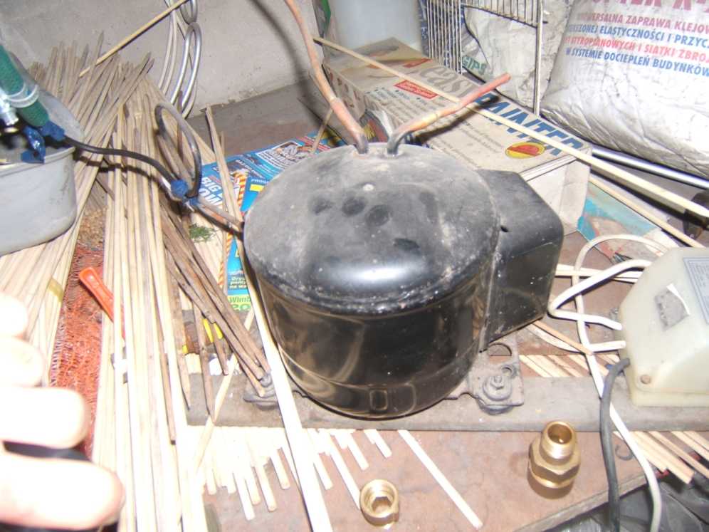

4. Provided you did everything in the right way the compressor you have just removed has 3 copper pipes sticking out of it and a cable. One of the tubes is an air inlet and the other one is where the air comes out, that 3rd pipe is already closed - it was used to fill the fridge with gas - it's not important.
5. Connect the cable to the power and add just any on/off switch (of course one rated to 115/230V (depending where you live) but I guess it goes without saying.
6. Now all you have to do is to connect the output tube with the rest of your setup. You can use a home-made compression fitting (that's the method I use), some people prefer to solder it. Back when I posted this thread I just used an air hose and a simple clamp.
7. It is advised to add an air filter to the pump - it doesn't have to be an off the shelf part - you can make your own air filter - a pen tube with some cotton inside would suffice (make sure that the cotton can't be sucked into the pump ) join the air filter with the pipe that is an air inlet and that's all

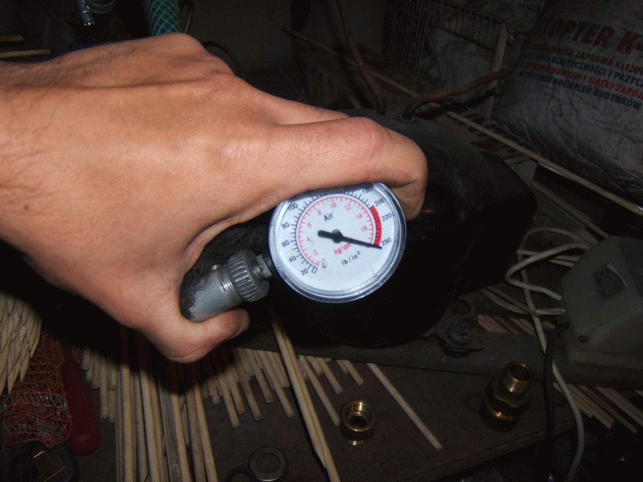

A guesstimate - 1.27 cm X 150 cm chamber to 250 psi in about 80 seconds - I would say that its flow is similar to a bike pump - only that it doesn't slow down when the pressure rises... so it no good for a bbmg. It can pump to high pressure but flow is lower. ahhh i forgot to add --->I advise to use quick connect fittings with this becasue the addapter to shreader valve is pushed by pressure from the valve at >200 psi.... so you have to press it to a shreader valve by hand
Alternatively, you can get a threaded connection for schraders, like the ones used in shock pumps.

It's capable of 35 atm.( that is 507 psi) althought I've never tried these pressures for safety reasons and because I don't even have a gauge for such high pressures :shock:

and I've tried pumping past 300 psi - possibly near 350 - 380 - (sorry I don't know exactly becasue my gauge is limmited to 300 psi...) I've used earplugs but I still hear ringing in my ears...:shock:
