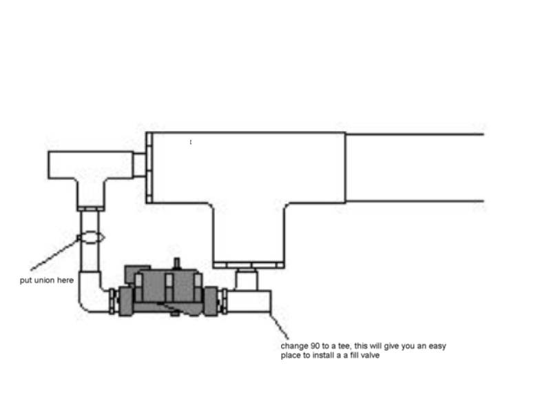

I sincerely apologize for kicking up this thread, but I just need to clarify what Grumpy said. I have here a diagram (or part of it) of what the Bergles Cannon will look like.
Now then, The long horizontal section of pipe on the left, if I put a union there, will I be able to unscrew that? (Sorry if this is a bit of a n00bish question, I haven't seen/held a union in the "physical world" so I'm not exactly sure how well it will work)
I would also like to apologize to Grumpy for having to deal will my lack of understanding, do you have any pictures to help me out?
Also, to clarify, the sections on either side of the sprinkler valve are elbows with one side of them being male adapters. I would like to use these to cut down on the length of the back section.
grumpy
Posts: 331
Location: tampa,fla.

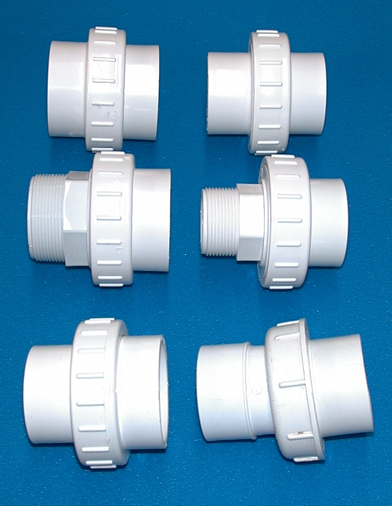

no need to apologiize i was not offended and do not mind ansewring questions, what size is the inner barrel going to be? well hope this turns out ok.
these are unions, i think most people here use to make burst disks
best i could do.
best i could do.
mega_swordman
Posts: 526
The barrel will be 1 1/2" and the sprinkler valve ( and corresponding parts around it) will be 1".
Thanks a lot, I get it now.
