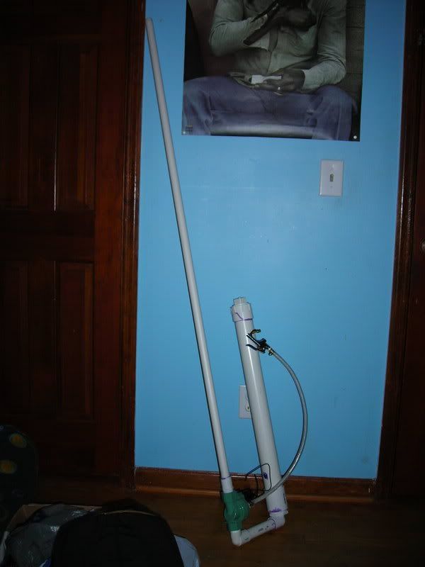

My first pneumatic.
NatoHub
Posts: 31
Joined: Mon May 14, 2007 3:48 pm
3/4" barrel (I might make more, since they screw on)
2" chamber
1" sprinkler valve
Pressure rated hose and blowgun valve
Presta valve with Schrader converter (had to buy at a bike shop)
I don't think it's too terrible for my first pneumatic.
Telling me anything I screwed up on would be greatly appreciated.
Thanks

Yeah its a good start, you've got a massive pilot volume, much more than you need. Also, if you don't want to reduce the gap between the barrel and chamber, then you'll be needing a support to take the stress off of those elbows.
Good job. :D

Yeah, I'm planning on putting a support between the barrel and chamber. It's pretty damn wobbly without one.

is that a clean out cap those are very dangerous on pnematic also cut down on the pilot volume a ton add barrel suports and damage pics also what are you pressurizing this at because if that is a cleanout dont pressurize it those usually arent pressure rated

Nice gun for a first, but why didnt you just put an endcap on the 2" chamber? It looks like the plug you put on the end is DWV, but again nice first.

Can I ask why you made your barrel so far off from the chamber?

reduce the distance between the tees for more support. Just use a cap instead of the cleanout. And how long is your barrel?
I made it like that so that I can fire it with the barrel resting on my shoulder, with the chamber under my arm. I'll add something to support the barrel better.

Makes a whole lot more sense put that way. You going to paint it? And how accurate is it?

I might paint it black...And I haven't got a chance to shoot it much yet. I've only shot a few batteries (and a glue stick, which just happened to fit perfectly) at a tree in my front yard. Seems pretty powerful. I think I'm gonna go to the soccer field tomorrow and see if it's accurate.

Hey Nato, nice first effort. What kind of damage does it produce?
I could picture JSR squirming in his seat as he took in, then in, then in that longish pilot hose :lol:

I bet that thing is fun to shoot.
The only thing I would suggest (besides dropping the cleanout) would be to add a barrel support. Also, for more comfort, have you considered mounting the blowgun?
