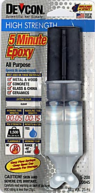

this is what you need, in home depo in the paint section they have an isle with all the glue and you will find this it works very well. even though it says 5 minute you should still let it cure 24 hrs.
Try some JB weld, leave it for at least a full day.
Side note:
It recommends 24 hours, but i've always had a small leak occur after 24 hours, so now I leave it for 3 days and I haven't had a problem since.

personally i prefer the loctite 5 minute set because one side is clear and one side is yellow and i can tell if the portions are equal
