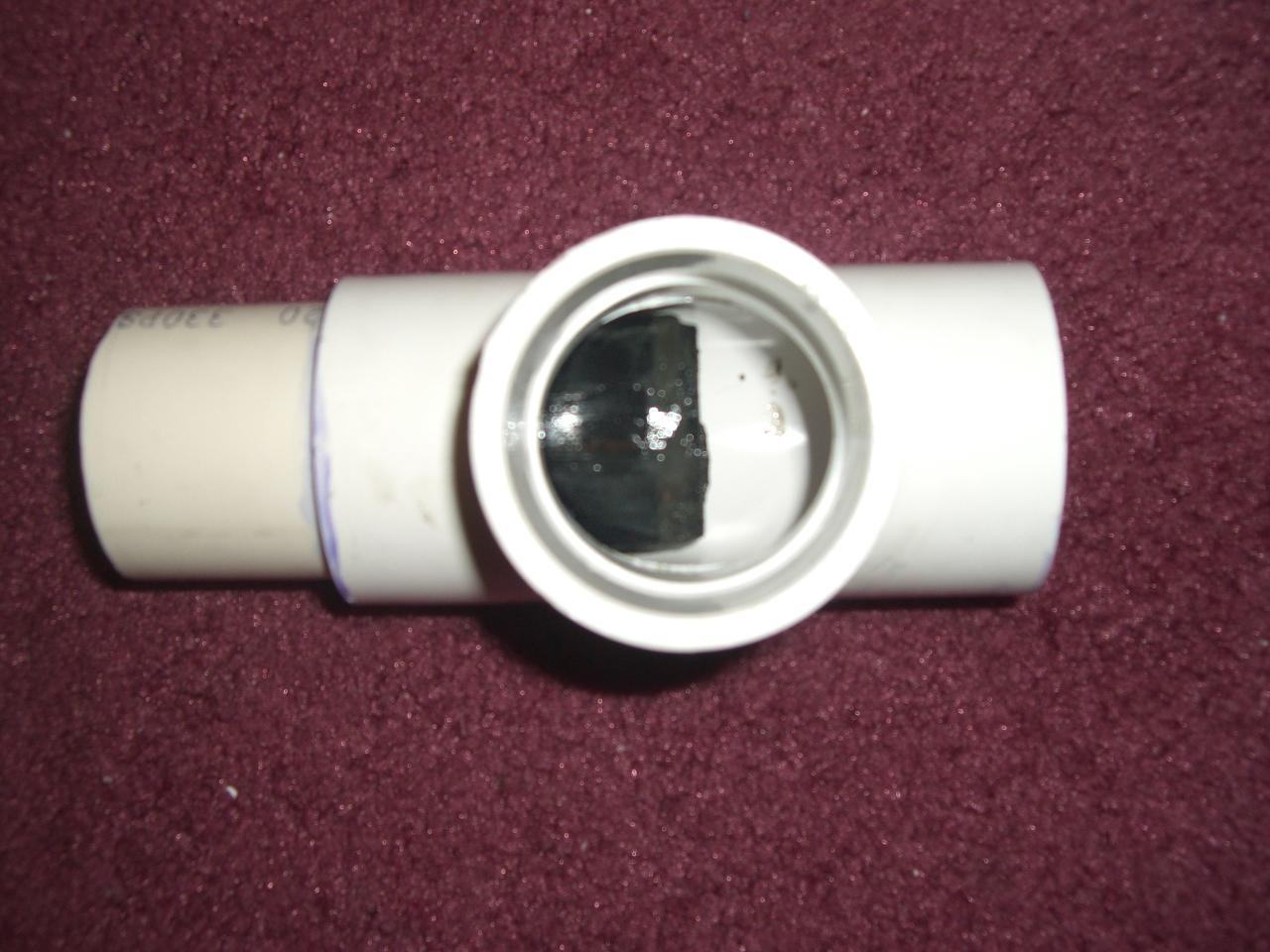

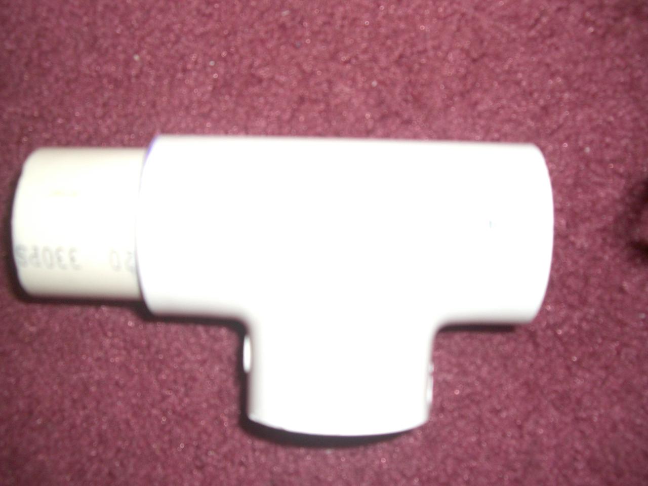

Is this ok?
- elitesniper
- Sergeant
- Posts: 1090
- ALIHISGREAT
- Staff Sergeant 3
- Posts: 1778
- Location: UK

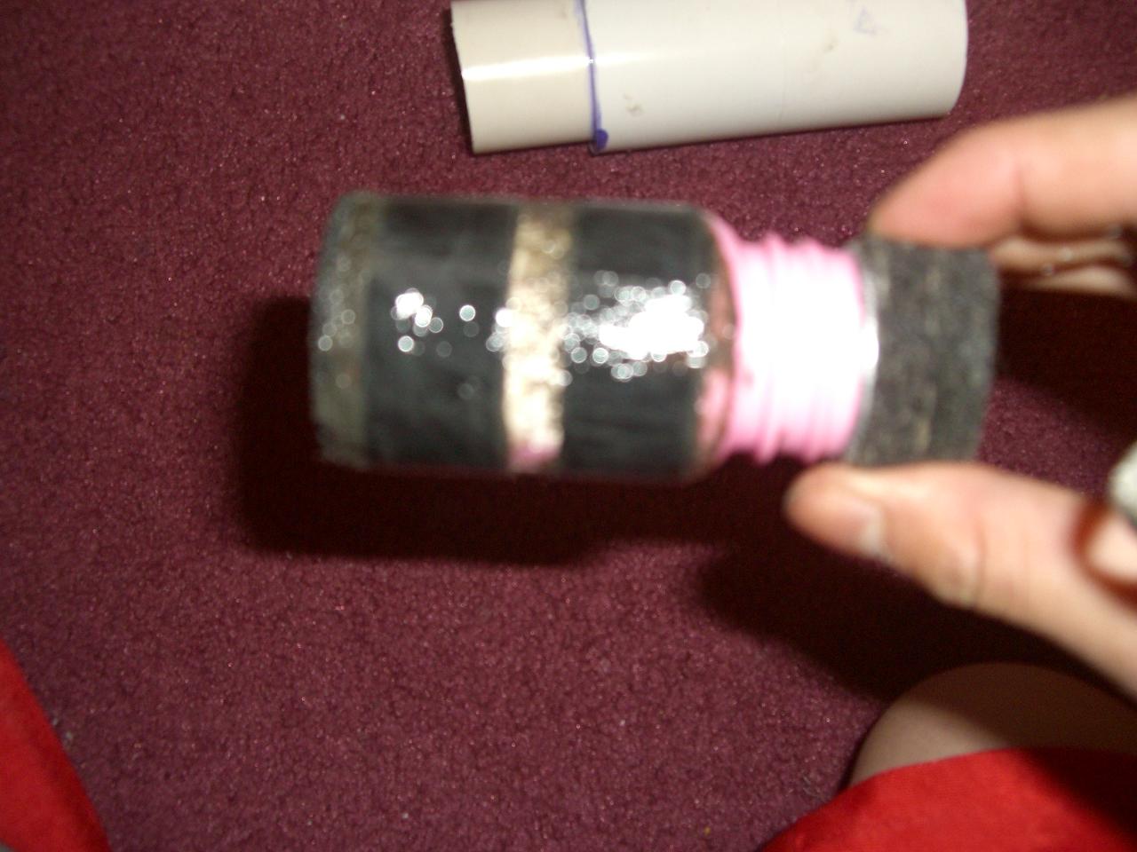

well the hollow piston could be a problem, how thick are the walls... if you are not cofident they are thick enough to holdback the pressure you will use you should fill it with epoxy or something.
- elitesniper
- Sergeant
- Posts: 1090
well there thick enough that i cant bend it with my fingers.
and one more thing home depot sells 1/4 female threaded tees right?
- mark.f
- Sergeant Major 4
- Posts: 3643
- Location: The Big Steezy
- Has thanked: 58 times
- Been thanked: 62 times
Drill holes into the hollow piston to prevent collapsing from compressed air on the outside.
Also, you may have problems with the sealing face. If the rubber foam is open-cell construction, air will leak through it.
Nothing wrong with a hollow piston, the lighter the better as long as it can take the pressure you're using and only one way to find out with a medicine bottle
- elitesniper
- Sergeant
- Posts: 1090
well its the pepto bismol one
seems prety sturdy so ill just try it. it should take the pressure if not ill just fill it with expanding foam or somthing, can i make it serviceable by using a threaded end cap in the back of the piston?
- mark.f
- Sergeant Major 4
- Posts: 3643
Just make sure it's a pressure rated plug, not a cleanout cap.

thanks but my piston isnt that short im guna put a threaded coupler thingy behind with a threded plug so i just unscreaw it to service it. :DWAIT and a blow gun will be enough to pilot the piston? since its very light.
- MrCrowley
- Posts: 10078
- Been thanked: 3 times
<A HREF="http://www.spudfiles.com/forums/the-tru ... tml">Don't forget the bumper, or else.</a>elitesniper wrote:thanks but my piston isnt that short im guna put a threaded coupler thingy behind with a threded plug so i just unscreaw it to service it. :DWAIT and a blow gun will be enough to pilot the piston? since its very light.
A blow gun should, if your piston is made well. Though I would recommend a 1/4" or 3/8" ball valve for best performance.

ouch thats gotta hurt MrCrowley
, but yea you can see the bumper behind the piston its epoxyed on there tight, its those cushiony things from drum symbols
