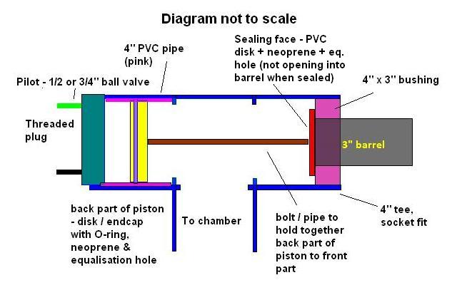

I'm thinking of building a piston valve for a cannon with a 3" (89mm outer diameter, 82mm inner diameter) barrel. The diagram of the proposed cannon should be in the attached file. Hope it is clear enough to be understood, though it isn't drawn to scale.

Proposed piston housing design - please comment. Thanks!
- Proposed piston housing. In theory, when the pilot opens, the pressure acting on the back of the piston should push the piston back - or will it?

It seems as though it would work, however why do you want to use this design and not a "solid" piston? It would seem that this design could constrict flow. Having said that i have never made a piston for a tee.

i think it would have better performance if the barrel protrudes into the tee, i'm not sure it would even work if it didn't. Also this is quite an interesting design because when the pilot is piloted there will be more surface area pushing the piston back than trying to hold it foreward which could give quicker opening times however the rear of the sealing face could get 'pulled' foreward by the air trying to exit the barrel which could cause slow opening times...
Actually, I was thinking of this design because I'm not sure if the impact of the piston on the back end (when the pilot is triggered) is enough to send the back part (pilot valve, schrader, endcap / plug etc) flying out, so I was thinking of playing it safe.
Was hoping if those of you with piston cannons could share a bit on this, since I don't know of anybody in my country with a piston cannon in my country.

ok well the seat is what the piston seals on with in this case will be the 3" barrel (don't forget wall thickness) which needs to be protruding into the tee (probable about half way) the flow coefficeint is how much can pass through it in a minute or something like that (but don't take my word for it, use google) and you just have to guess the friction but it will be very little.[/i]limbeh wrote:Actually, I was thinking of this design because I'm not sure if the impact of the piston on the back end (when the pilot is triggered) is enough to send the back part (pilot valve, schrader, endcap / plug etc) flying out, so I was thinking of playing it safe.

I believe this to be a 'Burke Lake' style piston. Yes, this valve has the abilty to open, but also the real chance of closing back up during the shot, as mentioned above. Installing check valve/s in your sealing face will help keep reclosour from happening.
The drag will happen when the piston assemble tilts directly after opening. To stop that you could make the sealing assembly the same inside diameter as the tee. I believe these changes to be nessisary or you will have problems.

Thanks guys. Finally managed to learn what seat and & flow coefficient means in 1 day when 2 months of searching got me nothing. As for the design, I'll probably revert to a normal design, to play it safe.

as it is it will be unstable, you need some full diameter supports on the red portion, or the yellow disk needs to be much thicker.

The design looks fairly good to me just fix what JSR told you to.

The biggest problem I see with this valve is that the sealing face sticks way out beyond the front of the piston. You will need to either support the sealing face or lengthen the piston skirt to prevent the face from returning to the seat at weird angles. I'd recommend potting the barrel end closer to to the center of the T, as even if you manage to not constrict the flow any, the added turns the air has to make will decrease performance.

well the front of the red end of the piston will be pushing back when the pilot is piloted and the front of the yellow piston but only the beack of the yellow piston will be resisting.Uhhh... Isn't that how piston valves work? I fail to see why that is such a special feature to this valve.

You failed entirely to consider the back of the sealing face of the piston, and the fact that it would entirely negate the force exerted by the front of the sealing face.ALIHISGREAT wrote:well the front of the red end of the piston will be pushing back when the pilot is piloted and the front of the yellow piston but only the beack of the yellow piston will be resisting.Uhhh... Isn't that how piston valves work? I fail to see why that is such a special feature to this valve.

please read my posts before saying i'm wronghowever the rear of the sealing face could get 'pulled' foreward by the air trying to exit the barrel which could cause slow opening times...
