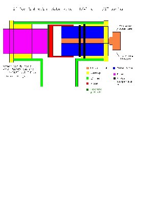

Specs,
All pipe is 1 1/4" sch 40 pvc with a pressure rating of 370psi
All fittings are sch 40 pvc pressure rated (to what?)
barrel 36"
chamber 48" approx.
piston is a 1 1/2" end cap faced off and bored to fit over the 1 1/4" fittings.
Bumper is a buna o-ring
sealing face is neoprene diaghragm material
Thanks, for looking, let me know what you think.

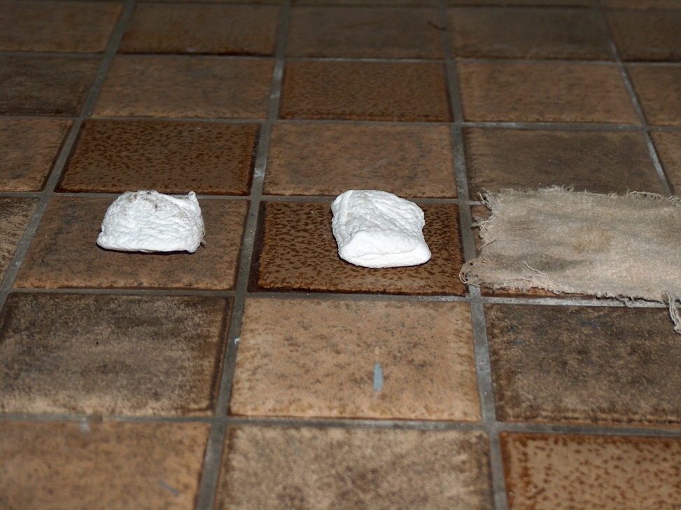

damage to marshmallows

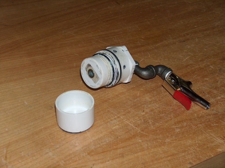

valve complete and closed

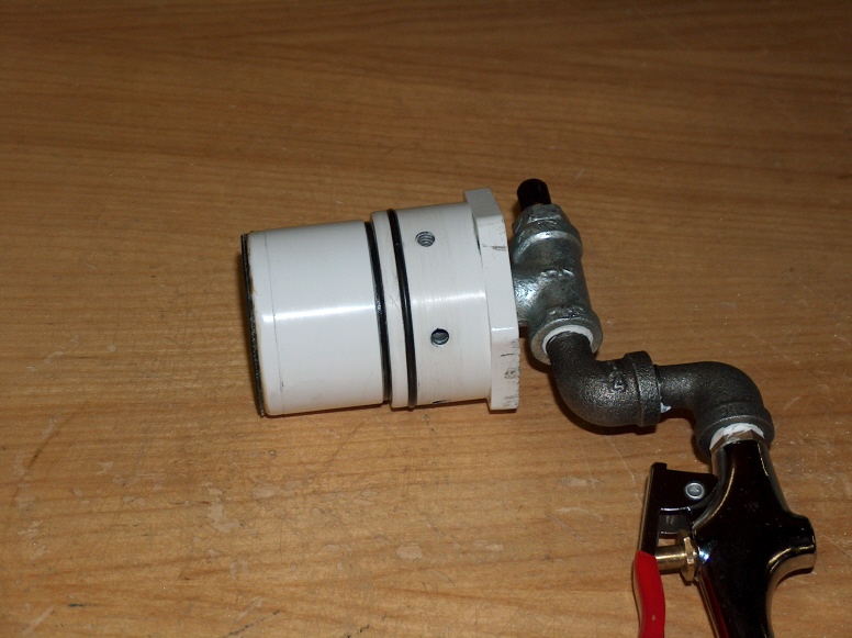

valve internals
valve internals

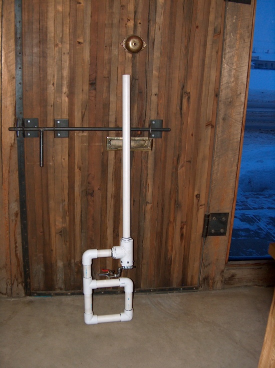

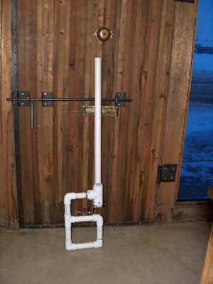

The complete cannon
The complete cannon

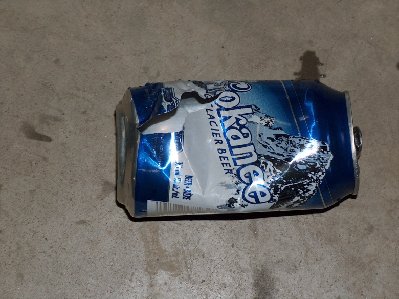

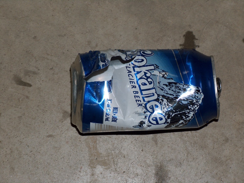

Can filled with water and shot @ 90psi<br />http://www.youtube.com/watch?v=miHGvreCPwA

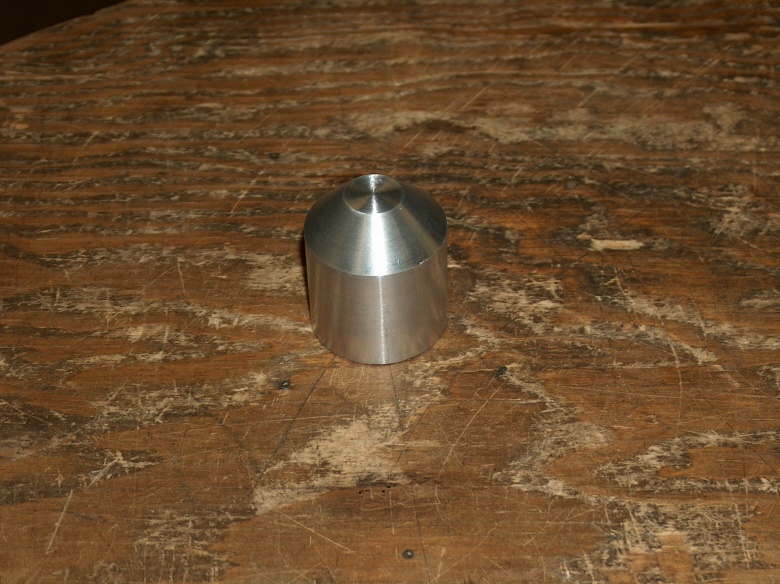

Worked up a new projectile. Will put up a vid when I shoot it. Hopefully this weekend.
Barrel sealer w/ light weight piston.

What pressure did you take it up to? And did you use more damaging ammo then just marshmellows?
Also, could we have damage pics or even a vid?

Very nice design, I like guns that start to look and get held like real guns.
I can just hear that marshmellow hitting with a splat. Does it stickum to the wall? Nicely done!

Psycix - I shoot at 90 psi (I fill with a regulator). It is currently -23 C here, this means indoor testing and non penetrating types of ammo. (the boss would be PISSED if I shot a hole in the wall) :shock: I'll see about a vid in the next couple days.
Elite - A golf ball barrel might be cool for spring.
jrrdw - It hits pretty hard, I sure wouldn't want to be down range. Disappointingly, they only stick occasionally. :(
