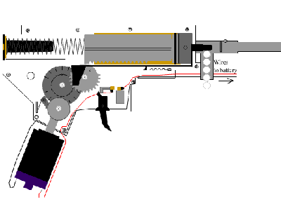

the main gear that pulls the piston back is simply a rack-and-pinion. it converts rotational movement to linear movement. toss one from an RC on a syringe plunger and your halfway there. getting your correct gear ratio is going to be the next problem, of course this depends on your spring rate. the stronger the spring, the lower your ratio needs to be to pull back your piston. this also depends on how strong your motor is. the stronger the motor the higher your ratio can be. there are also other design factors to consider, like rate of fire. this will also determine your gear ratio on your rack-and-pinion. as you can see in your gif, the pin/ramp combination on the pinion for the bolt has to be correct or you could face double loading of BBs or BBs not firing on the compression stroke.
