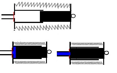

Well I have absolutely no idea If this will work but I don't see why it shouldn't.
After the release clip on the back of the piston is released, the piston is pulled foward extremely quick due to the strong springs pulling it in. At the peak of compression, the burst disk should give out thus sending a wall of compressed air. It's somewhat impracticle but eh....I'll make it and see what happens :D.
Edit: The ring at the back will be attatched to a trigger mechanism.
The 3 stages.
The 3 stages.

I get it, like putting a burst disk in front of a syringe.
Nice idea i think it will opening the valve faster :-D

It will work, but you need an airtight and low friction piston (a dismantled bicycle pump would be perfect) and a hefty spring if you want decent power. As I always say in these cases, it's not worth the effort.
The only reason I'd see for making a springer is if you need a compact and self contained launcher that is independent of compressors or air tanks.

Yeah thats exactly right. I came up with that little plan because I want a average power bb pistol, just something I can use to do some can shooting inside with my mates after a few beers (:D Might be dangerous...) Having a mounted shocky even with a small chamber size, just takes too long to pump up...
Cheap airsoft pistols with tiny pistons and sh!tty springs get 250 fps or so, if you can make the construction strong enough (generous use of epoxy recommended) to allow the trigger to restrain a reasonably powerful spring (you can take a few hints from how commercial springers are built) I'm sure you can double that at least, especually with a burst disk - though the latter would add complexity to reloading, why not just use an o-ring in the breech to retain the projectile while pressure builds up.

Yeah thats a good plan you got there Jack. An o-ring would be alot easier and cheaper parts wise. I have a couple of springs from an umbrella mechanism, they are decent sized springs....very, very tough. It's all food for thought anyway :D.
Don't forget that the wider your piston, the less it has to travel, and make sure the barrel volume is not more than the swept volume of the piston.

I was planning on using a 5in long piece of 1in poly pipe or a long brass nipple. Hmmm... With a decent de-compression of the spring, at it's peak, what would I be looking at for a PSI level? Just a total rough guess..
Without knowing the strength of the spring (that would give you the maximum theoretical psi possible) and the pressure at which the projectile would start moving, it's impossible to give you an estimate.
