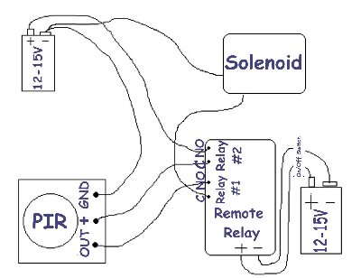

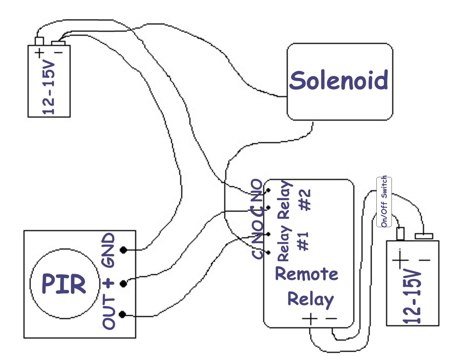

what is the PIR in the picture below?:
Davidvaini wrote:what is the PIR
One of these, very popular with insugent IED techs in Iraq apparently.
