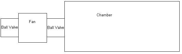

While asking questions about my hybrid, I touched on the topic of a fan. It was immediately noted that a fan would be destroyed in a hybrid. It was also noted that one is not really necessary due to the air injection.
I know a chamber fan drastically increases the performance of a combustion and thought it may do the same with a hybrid, although I'm not sure.
Here is a couple of thoughts of mine to integrate a fan onto a hybrid and keep it from being destroyed through detonation.
Both designs incorporate ball valves to protect the fan from the detonation. Open the valve(s), operate the fan, close the valve(s), fire the launcher.
Thoughts?
Hybrid Fan
- In this design, the fan is set up similar to a metering system. Once the fuel is injected, the ball valves are open and the fan turned on, allowing the fuel to mix.
- hybrid fan1.jpg (7.03 KiB) Viewed 4017 times

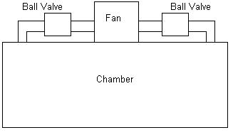

- This is a better design, in my opinion, than the first design. It allows the fan not only to mix fuel, but also allows it to exhaust the fumes.
- hybrid fan2.jpg (7.81 KiB) Viewed 4017 times

The first design looks like what I suggested to D_Hall for his "big-ass" gun. Basically a re-circ loop.
The second... I don't think it is going to mix very well. Probably better than nothing but not nearly as effective as the first design.

Jimmy: In the first design, it is just to mix the air and fuel. The second is a more conventional type, common in a lot of combustion launchers. This one may be used to generate turbulence, but I would think in a hybrid, it would be more prone to causing DDT.
Fnord: I'm not really sure I follow that. The chamber is not going to be blocked off. The first design just allows the fan to be out of reach of the chamber when it is fired to help protect it.
