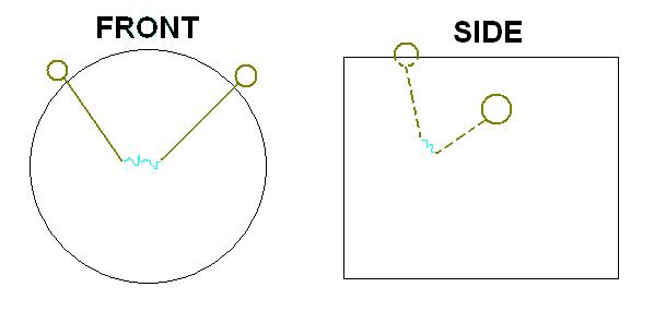

hey guys, i'm building a hybrid and I was wondering what the best place could be for an igniter.
Tapped in the chamber is not an option, since I don't want any holes in in xD.
Maybe in a T-pipe at the end of the chamber??
All help is welcome :)
thnx.

Hubb
Posts: 2390
Location: South Georgia
http://www.spudfiles.com/forums/a-few-h ... rt,15.html
Check out the fifth post down. I had the same problem when I built my hybrid and I did not want to tap into the side of the chamber. The above pic should help you out. It is very easy to construct.
When I built my hybrid, I changed it around a little, but it will give you a general idea of how I placed my spark in the center without tapping a hole in the chamber.
xzenir
Posts: 4
Joined: Mon Mar 31, 2008 7:26 am
aah thnx,, images can say more than words !:P
now I should be able to make a nice ignition on my gun xD

Hubb
Posts: 2390
In my launcher, the spark is placed in the center. It is in the direct center. It took several pieces of coathangers to get it this way, but it works wonderfully, AND I didn't have to drill into my chamber, compromising its integrity.
As far as the angle goes, that would be kind of hard to accomplish with the small cap, but I bent the tips at an angle. Does that count?

Hubb
Posts: 2390
I did bend it. The tips are bent closer to keep the spark at its tip.
