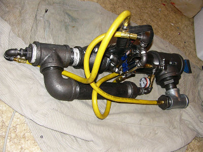

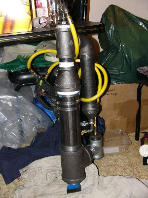

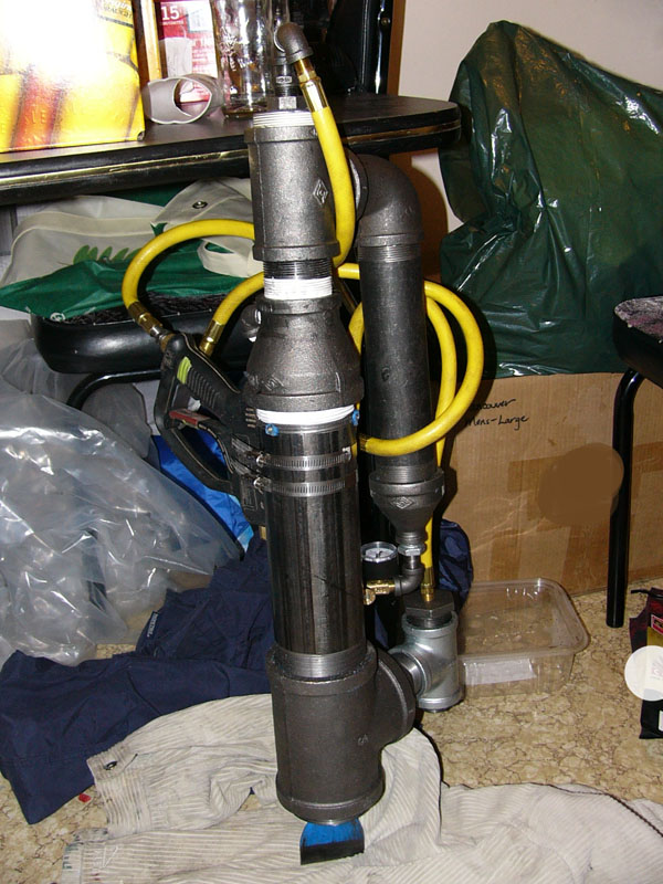

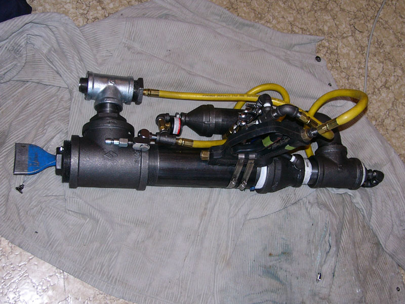

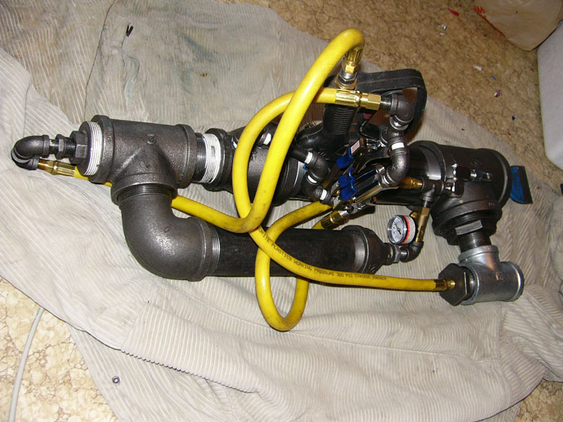

The last project I posted never ended up getting finished, so this time I thought I'd finish one and then post!

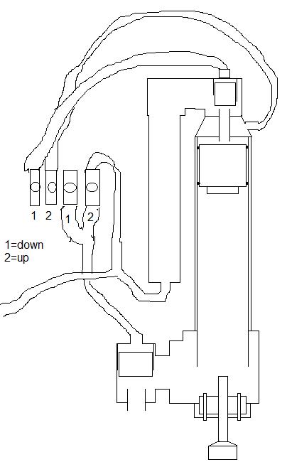

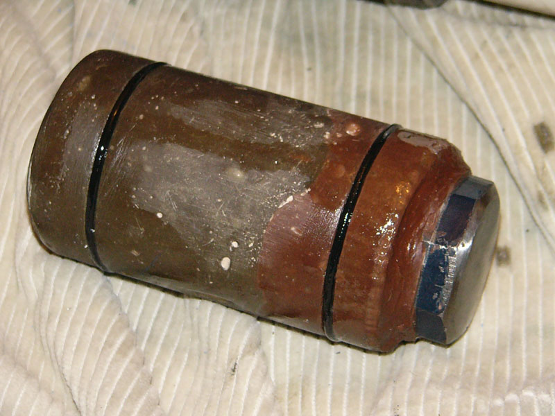

This isn't a cannon, but uses many of the same principles, so I thought it might be interesting to those on this forum. It's a single impact air powered chisel. Air chisels already exist, but they have many small impacts, instead of one controlled large one. My dad needed something like this for use in his rock quarry for shaping rock, as people that can wield a sledge hammer all day are few and far between.

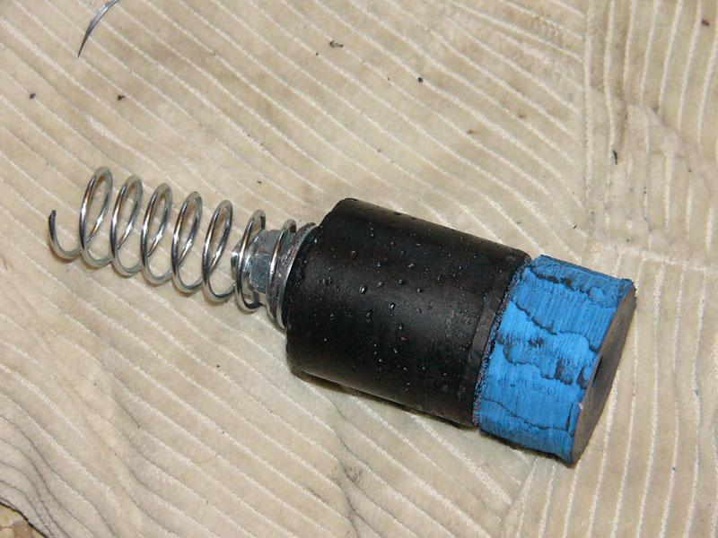

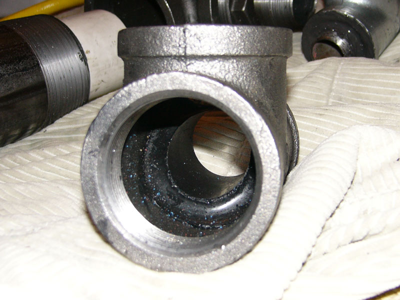

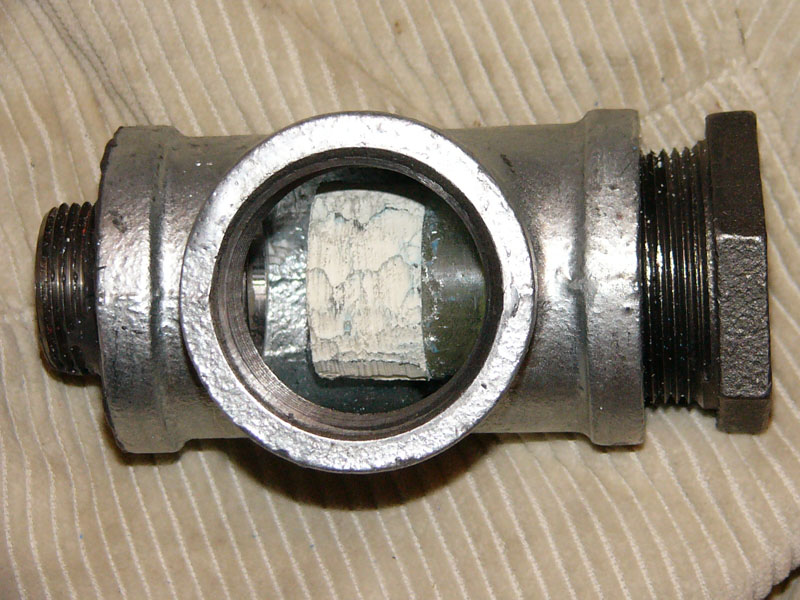

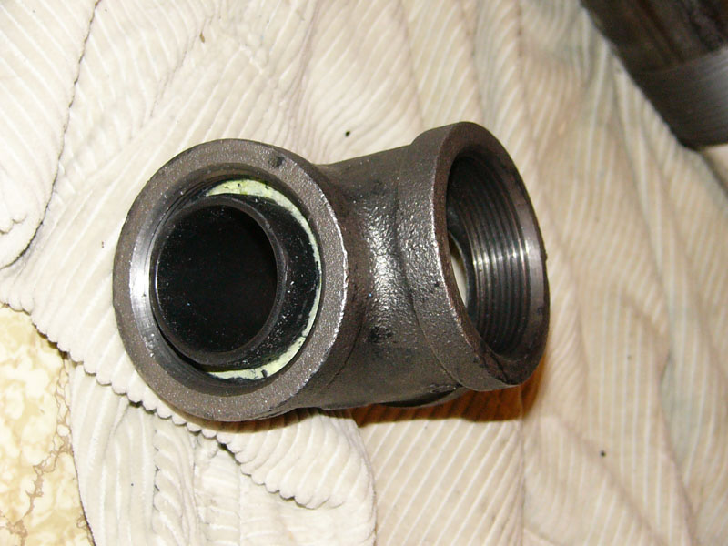

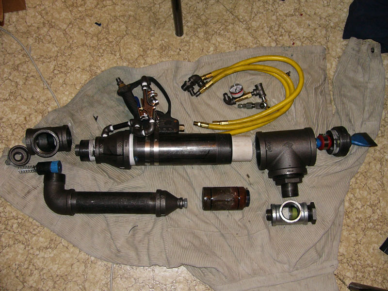

The diagram and pictures should be self explanatory, but basically it consists of a chamber, main piston valve, barrel, 4lb sledge hammer sleeved in bondo w/o-rings, chisel and guide, small piston valve for barrel venting and pressurizing, and 4 control valves (1 pressure washing gun and 3 blow guns).
Unfortunately I don't have a compressor to test it here, but I'm shipping it to my dad soon - I'll update when he tests it.

Very nice, I really like your design.
How hard do you expect it to impact?

Thanks guys.

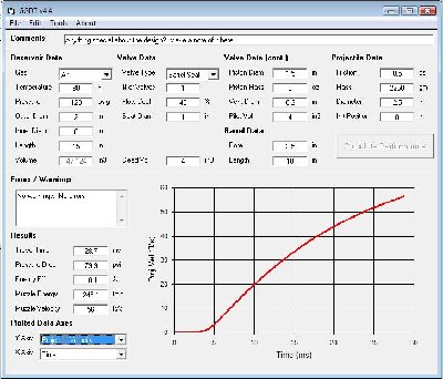

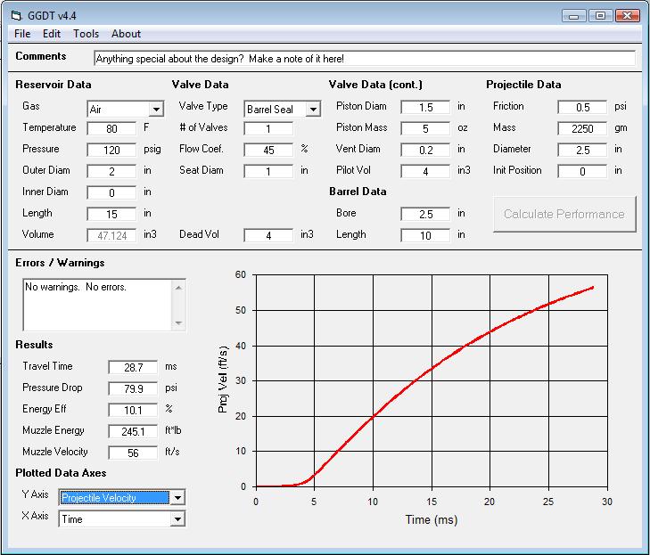

I did a small scale test with an old solenoid valve cannon and compared that to what I could do by hand, and it needed to be about 5x more powerful, which is what this is. So it should be equivalent to using the same sledge hammer by hand. It can be adjusted relatively easily though by extending the barrel and/or chamber.
It is finished I just disassembled it to show the components.
Full auto eh? Let's see if this works first! Actually, auto is why commercial ones won't work for this application, so I don't think that's on the drawing boards.

Looks beastly. Except I'm kinda lost on how it works. Does it recycle its own air?
daccel
Posts: 238
Joined: Thu Oct 11, 2007 9:51 pm
Location: BC, Canada
No recycling, the used air is vented. Essentially, on the down stroke you first trigger the pilot for the piston valve at the bottom, then the main piston valve. As the hammer travels down it pushes the air ahead of it out of the lower piston valve. The hammer transmits virtually all of its force to the chisel and stops. There is a rubber ring at the top of the chisel that seals the hole it travels through. To move the hammer back up, the air behind the hammer is vented and the space in front of it is pressurized through the pilot of the lower piston valve. When the vent above the hammer is closed it creates an air lock which holds the hammer in position. Then the pilot of the lower piston valve is triggered, which de-pressurizes the space ahead of the hammer. And repeat.

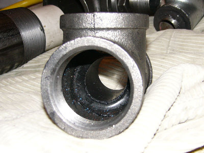

That chamber looks like 3" pipe to me, and the one on the GGDT model says 2". Try it with unregged CO<sub>2</sub>, and you'll get an hour's worth of hammering done in one shot.
daccel
Posts: 238
The chamber is 2", the barrel is 3" with 2.5" pvc sleeved inside, because I couldn't get seamless steel pipe easily. Haha, yes, and then you can use the remaining 59 mins to nurse your sprained wrists.
But mentioning CO2 gives me an idea, reg'd down to 120psi a 10lb bottle would give you 400 shots if my calculations are correct. That could potentially be useful for places where you couldn't get a compressor to or didn't want to run air lines.
