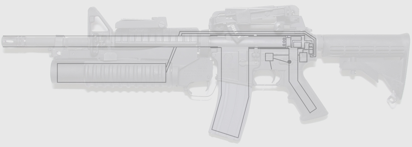

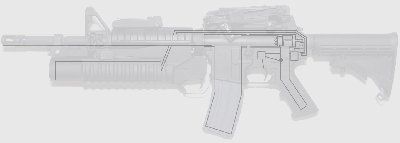

I thought I had read most of the posts on semi/auto designs, but then came across Clide's slider tonight - don't know how I missed that. Anyways, I think it could work well for this design, using a solenoid to move the slide valve, but would need some sort of switch that pulsed the electricity at the appropriate rate, and even better have the rate adjustable. Is a switch like that feasible to make or adapt from something else?
Attached is what I was thinking for layout.

You could try looking for a 3-way solenoid valve instead of having a solenoid push a slide valve; it would probably be capable of cycling on and off faster.
I can't really help you with the electronics though, not my field of experience.
Do you have a plan for a loading mechanism? A solenoid like you planned on using for the slide valve might make a pretty good loading mechanism.
Yeah, I was looking on Mcmaster at all the solenoids, but the three way ones seem to all have lower pressure ratings than the two way's, and I would like to eventually run it off of unreg'd co2 to get enough performance out of the small components that the shell limits me to. Even the two way's may not fit. I'm also not sure that those small direct acting solenoid valves would have enough flow to pilot the piston properly?
It might help the cycling speed if I used several solenoids side by side to make sure there's enough force to open the slide valve. I think using custom parts like this will be easier to fit together in the limited space, without sacrificing the goal of not changing the outward appearance.
The electronics is doable, I'm sure, just have to spend some time researching it and asking on some electronics forums.
For the loading mechanism, I was originally going to use a blow forward bolt, but have been thinking about the solenoid idea like you mentioned. I want to be able to have projectiles that are the full length of the magazine (2-2.5"?), and with a low volume, high pressure chamber the blow forward bolt begins to affect performance with that much travel, because you have so much space between the valve and projectile.
Since I'm already using electronics, a solenoid could be a good way to fix this - just have it move a tube over the breech. However, most of the solenoids I was looking at had limited travel, so it may need several hooked up inline (core to case).
