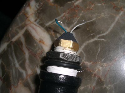

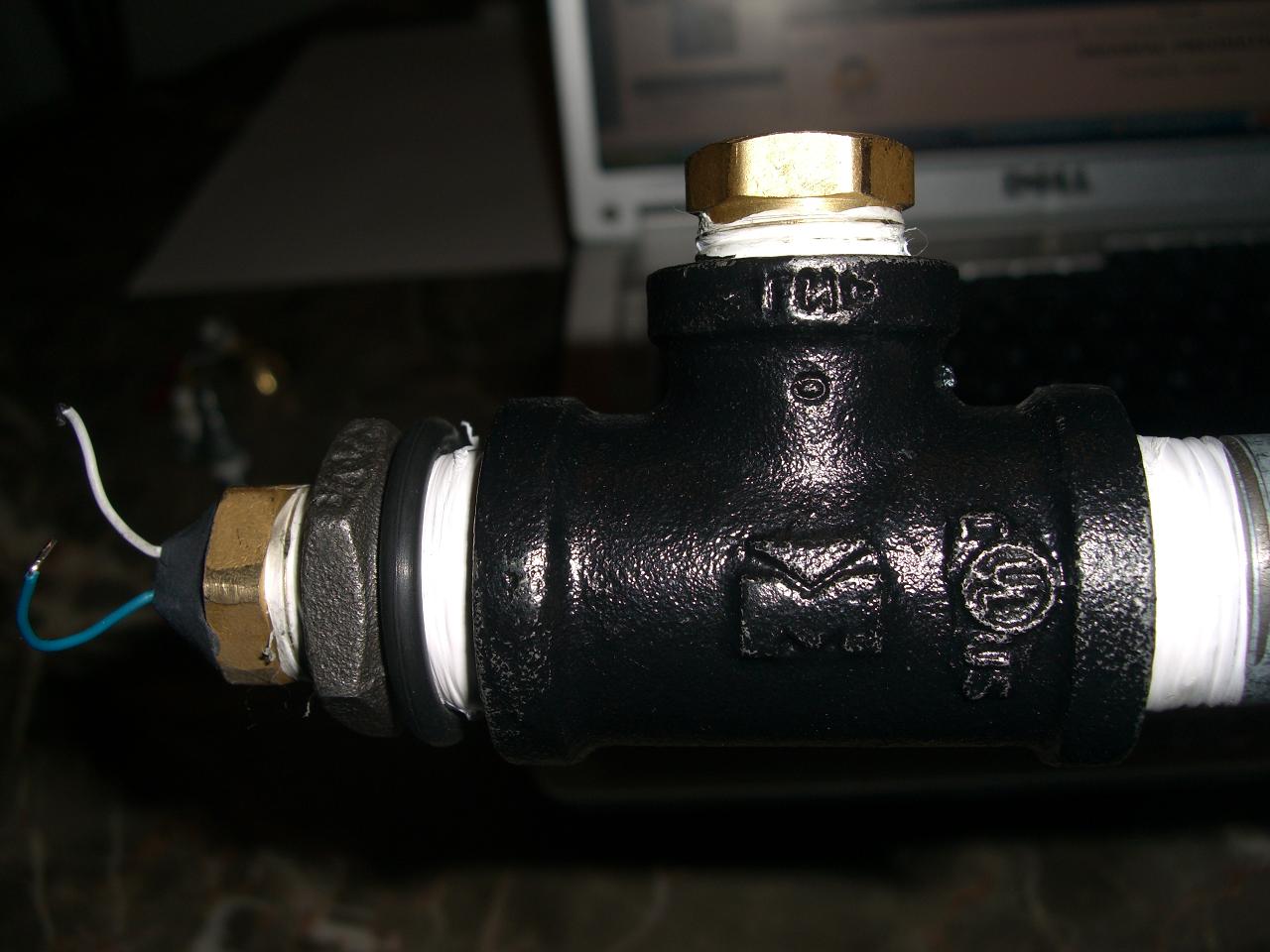

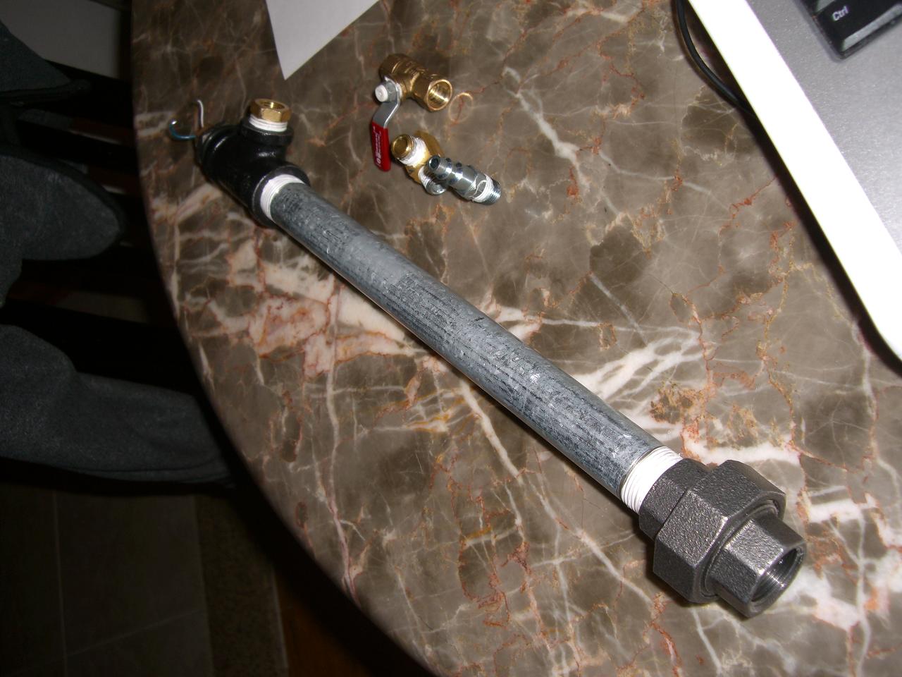

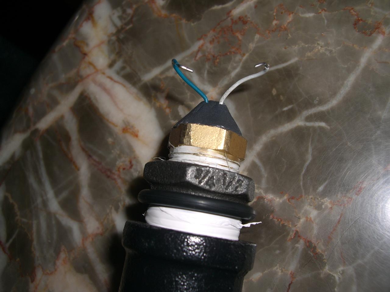

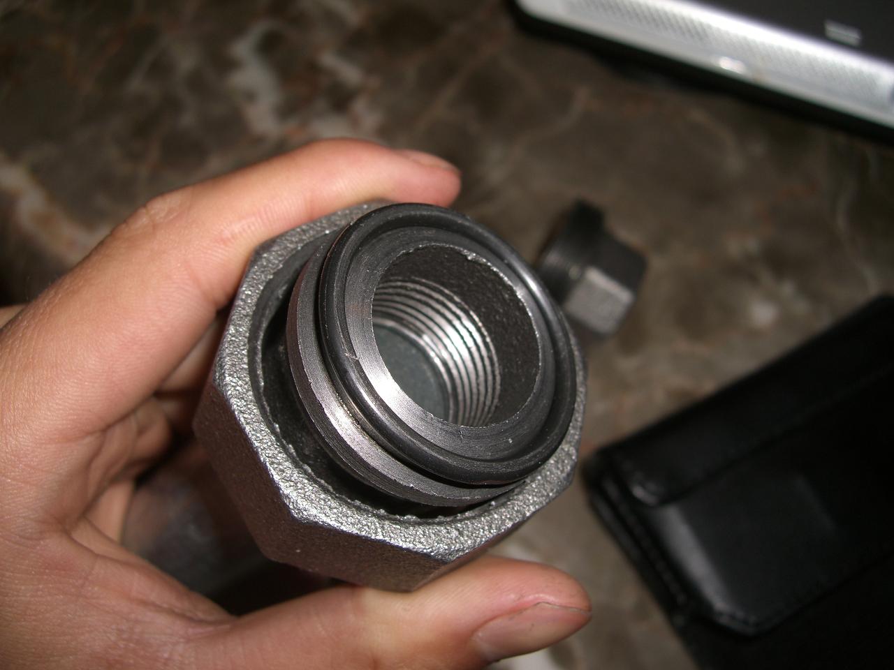

well, guys just asking for some advise, im stepping up a step from piston valves to hybrids( don't worry I will always stay loyal to pistons
) I want this to be a reliability safe launcher and very high performance like breaking the sound barrier, at maby a 10x mix?, anyways the point of this topic is to show you what I have for now and so I need you to judge if this can handle these mixes safely, pipe is a foot of 3/4 galv steel, union 3/4 black iron, tee black iron 3/4, with a homemade brass/iron spark plug. Im going to add a sch80 pvc 1/2, 4 feet of barrel.What'd ya think guys?

I guess its sch 40? but I thought this might be able to handle high pressures due to the small diameter, yes this is all from homedepot

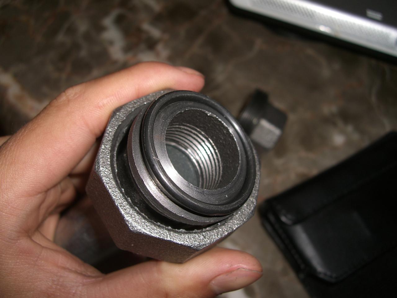

That chamber looks a bit too long and skinny for my liking. Looks like a bit of a detonation hazard. It probably will be fine though. How do you plan on sealing the union? (there's no way that an o-ring will work).
The fittings and pipe look like the SCH 40 style to me.

Well the union sealed pretty well at 190 psi propane pressure
what it may ddt? but this pipe should be able to handle it right?

No it will not handle a ddt vey well at all. Sch 80 steel would survive a couple but this will get damaged if not fail completely.
I dont think this would be safe above 6x or 7x mixes unless all those fittings are special high pressure ones.
If they are ones from a hardware store then they will blow off for sure.
You would also need a special high pressure ball valve as the normal ones would have a chance of failing at that pressure.
So to sum it up, no it is not safe although others may disagree.

well the ball valve you see next to it is rated 3000psi, but the pipe is supposed to be for steam and high pressure gasses,I think, I don't really know, I talked to Fnord a few days ago and he said to could could take 15x mixes but that was his own educated guess, since I knew he had hybrid knowledge.

What about the fittings, what are they rated too, including the brass ones.elitesniper wrote:well the ball valve you see next to it is rated 3000psi, but the pipe is supposed to be for steam and high pressure gasses,I think, I don't really know, I talked to Fnord a few days ago and he said to could could take 15x mixes but that was his own educated guess, since I knew he had hybrid knowledge.
And were did you get that 3000psi ball valve?
You can get a foot of sch 160 for $28. here is the part number on mcmaster 7733K147. this could hold 15x most likely.

i would never ever use this above 6x.
and i have used a O-ring in my union and it works at 6x with aluminium foil when i screw it with my hand.
