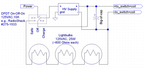

Anyone know how to calculate the bleeder resistor for a given capacitor?

By "bleeder resistor" you mean a resistor to discharge the big-ass cap through to make it safe?rp181 wrote:Anyone know how to calculate the bleeder resistor for a given capacitor?
As a rough estimate you can just use ohms law. The peak (initial) current out of a cap charged to 300V discharging through a 1K ohm resistor is 0.3A. 0.3A at 300V is 100 watts. So a 1Kohm, 1/4watt resistor will probably detonate.
If all you had was 1/4watt resistors then the total intial power is less than 0.25W (that would be a very conservative design). At 300V that would be 0.8mA. 300V at 0.8mA is a 375Kohm resistor. If your cap is 1,000uF then it'll discharge ~67% through a 375Kohm in ~6 minutes. The resistor will get hot but it shouldn't have any problems.
The best (cheapest, most readily available...) bleed resistor is just a couple of 120VAC light bulbs. A 100W light bulb is about a 100 Ohm resistor rated to 100W. That would be a pretty expensive resistor if you tried to buy an actual power resistor of that size. If your cap is charged to 300VDC then you probably want to use two 120VAC bulbs in series since initially you are running them at more than twice their rated voltage.
Assuming a 1,000uF cap charged to 300v then disharged through a pair of 100W bulbs in series;
RC = (200ohms)(0.001F)=0.2 seconds to disharge the cap to ~33% of it's initial voltage. Basically, the light bulbs would just blink.
Initial peak current through the bulbs would be 300V/200ohm=1.5A. Inital peak power would be (1.5A)(300V)=450W. Two bulbs, so 225W each. That's twice their power rating but the pulse only last for a fraction of a second.
My personal favorite bleed resistors are three or four of the small 25W 120VAC bulbs used in nightlights wired in series. (The kind that used to be used as Christmas tree lights.) Roughly 400ohms each, several in series will discharge a big-ass cap in a few seconds.
