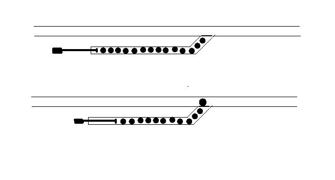

So that when the chamber is filled the pressure will force the round into the trigger and the round will compress and the rubber will be pushed out so that it seals in the barrel then when the trigger is released the round springs open so that the pressure can push it down the barrel.I have an idea for the pump action part. have a tube with a 45 degree elbow below the barrel.put an oring across inside the pipe near the top to keep all of them from coming out. put a stick in the other side that seals in the pipe. this is too hard to explain i will post a pic.
i think this would work

@ pat123
I think that setup will blow out the "stick", and make it act like a pneumatic ram, and all balls will fly out too if things break.
