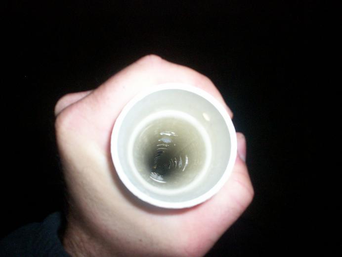

down barrel
down barrel

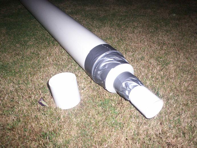

silencer with 50mm coupler for size comparison

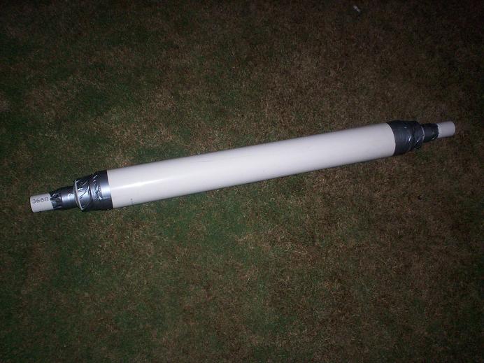

whole silencer
whole silencer
