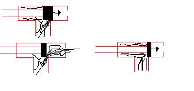

SpudFarm
Posts: 2571
hmm is your piston thin? mabe there is a gap from the chamber to the pilot side via behind the piston :D

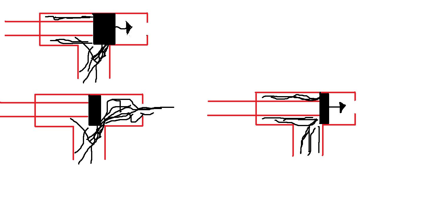

SpudFarm
Posts: 2571
daberno123 wrote:If by thin you mean short in length, then I don't think so, but how short would be too short? The piston rests in a section of pipe and I don't think there are any gaps.
my valve it completely sealet behind the "gap" in the back of the tee. (equalizion holes (?) )
hard to explain so i make some crappy diagrams..
Edit: the diagram are in (ask)
down left is yours and the one above is what you can do and the other one is how i do it

Thanks for the diagram spudfarm. I took apart the valve and my piston is like the top left one, not the bottom left. It seems to have proper equilization holes. I tested it by blowing behind the piston. The air slowly leaked through, not in a rush like in the bottom left one.

SpudFarm
Posts: 2571
good looking, i am agree with jrrdw here.. to much gap and some sort of jamming.
do you have the tools/time to make two simple o-ring grooves in it?
i wouls have taken the time to use the dremel tool to make two grooves. one at the front and one at the back.
mabe you can try to make a piston like the one on the diagram but add a neoprene washer longer back to?
first you have to try to make the piston fit so tight you feel a slight restistance (?) when you push it. more tape!
