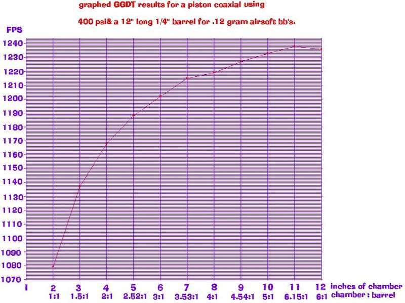

Thought you guys might find this interesting or have some opinions. I'm trying to decide on a good C:B ratio, and I thought visualizing it might help, so I drew a graph. I'll put it up in jpeg and bitmap incase one is clearer than the other. Here you go:
<a href="http://s117.photobucket.com/albums/o75/ ... injpeg.jpg" target="_blank"><img src="http://i117.photobucket.com/albums/o75/ ... injpeg.jpg" border="0" alt="jpeg graph"></a>
EDIT: I guess photobucket switches everything to jpeg so I erased the other pic....
What do you think?

hmmm I don't understand why 11 inch chamber results in higher MV than 12 inch chamber
anyway nice graph it shows quite well that increasing chamber size is pointles above some point

ya, I figured that was just a goof on GGDT's part but who knows... so do you think I should go for 11" chamber, and a 6:1 ratio?

nah... 6 inch chamber is the longest I would use.... but hey it's up to you.. it depends what you need etc.
if you want to build a plinker you should choose for example a 3 inch chamber as it can be easily pumped and it is still offers good velocity
if you want more velocity you will choose 12" chamber
first of all you have to decide what is important for you... keep in mind that 0.12g BB would loose its speed very fast so consider using heavier ammo ( 6mm ballbearings are 1g each) what is more, iI don't think you will notice the difference between 1140 fps and 1240 fps so it might be said that it doesnt make much sense to go for anything longer than 6" (but 3" is still quite good and you could pump it faster)
A small chamber will do.
Note that your graph is somewhat misleading to the eye:
It starts at 1070 fps.
If you would make one starting with 0 fps, you would see that the difference between the c:b ratio is not very big.
20% more speed, for a 600% as big chamber....
I would go with a small chamber. 4"will certainly be more then enough.

Like psycix said, very small increase in performance for a huge increase in chamber volume.
Instead of increasing the chamber you'll get a heck of a lot more "bang for your buck" if you add an inch to the barrel length.
Redo your analysis with a 13" barrel. I think you'll find that'll the performance increases a heck of a lot more with the slightly longer barrel than it does because of increasing the CB from say 3:1 to 6:1.

Thanx for all the opinions guys. Seems everybody is in the same boat on this one. I was planning on highest velocity possible, but I think I will cut it back to 6 inches now.
Psycix, I wanted the graph to be very excentuated so the curve would be very easy to get an opinion on. I was kinda curious what it would look like though if I had started at 0" of chamber and 0fps.
I do have a large stirrup pump so any of the sizes would be relatively quick to fill up. But I suppose that, still, the quicker the better.
So what do you guys think a 1200 fps plastic bb will do?
Or a 6mm ball bearing for that matter which will end up going 917 fps?
