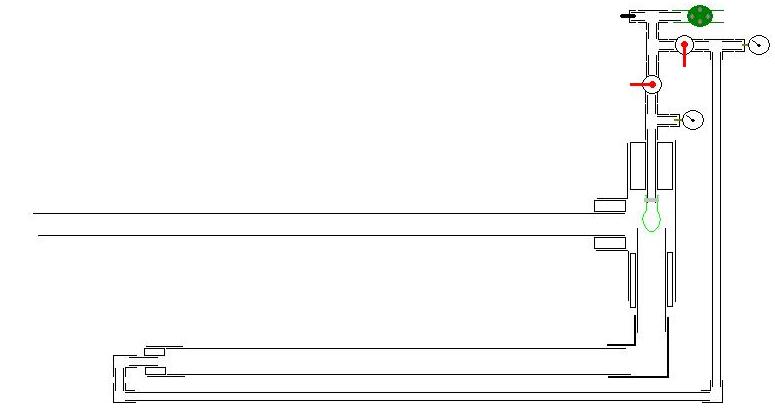

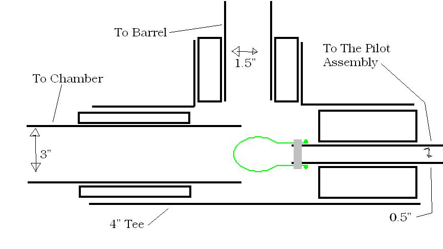

This is a new kind of valve( of my design) that seals the chamber with an inflatable something (probably a few ballons inside each other) and should achieve power levels upwards of those attained by the Supah valve, despite the fact this doesn't use o rings
It is attached to the pipe with a universal clip ( those metal bands which you tighten with a screw that you find on hosepipes) that is kept at a higher pressure ( and therefore inflated ) by the valve assembly.
Unfortunately you would have to keep switching back and forth between which valve was open to keep the pressure differential the same. Oh well, the power makes it worth it.
Some largish holes would be drilled in the end of the chamber inside the tee to give the balloon some purchase on the pipe
The cannon wouldn't be as tall as it is in the image but the scale is out of wack
I will be using this design for my next large-bore, but that won't be for a while as parts for a different one will arrive in about 2 days.
Anyone is free to use this design as I want to see how it comes out (although I could hardly stop you anyway)
For reference: the light green thing is the balloon, the dark green thing is a solenoid.

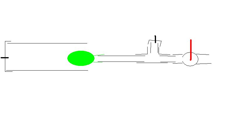

I could test this for about (less than) 10 GBP with just the balloon valve, without a tee, and two schraders to fill a small (short, 3" pipe) tank with an end cap

Entirely New Valve Design (Balloon)
- And its implementation in a launcher
- implementation of the new valve.JPG (21.87 KiB) Viewed 6309 times
- The valve. The tee is 4 inch but the image is poor
- A Entirly New Valve Design.JPG (30.54 KiB) Viewed 6309 times
- This is how I could test it, Sorry for the scruffyness, it was done quickly
- Prototype for valve.JPG (11.86 KiB) Viewed 6115 times

Looks like an interesting concept. Although I would be worried about the strength of the balloon.
Oh and wouldn't the pressure in the chamber be higher then that in the ballon which would allow the chamber air to push the ballon out of the way?
In epoxy we trust.
That's the reason for all the valves, you can keep the pressure higher in the balloon.
It would also be a layered balloon for strength and the chamber inside would have some holes in it to give the balloon purchase

It looks like it could work, but perhaps it would be an idea to use the bladder from a small football instead of a balloon as it would be stronger

I see a couple of possible glitches .
the bladder not releasing from the barrel due to lack of pressure difference or any force to offset the chamber pressure
the bladder sucking into the barrel and choking/disrupting airflow

Isn't the ballon going to have to be pressurized to the chamber pressure (or a bit more)? But part of the balloon has an external pressure equal to atmospheric.
Any thoughts on what kind of balloon can handle more than 100 PSI? WAG for a generic toy ballon is it'll burst at just a couple PSI. Even if you put ten of them inside each other is there even a remote chance you can get it up to >100 PSIG?

I think it will work. It will be much easier to get it to seal than a piston would be.
let me see if i get it.
1. pump more pressure into the baloon than you are planning on using in the chamber.
2. close valve to balloon and pump the chamber up to a pressure a little lower than the balloon.
3. close the valve to the chamber andopen the valve to the balloon to fire.
did i get it right?

i tried it a while back, it leaks like crazy, and baloons keep poping.

You may try placing a small (1/4" will do) valve behind your ammo stop, that will open the base of the barrel to the atmosphere. Then using a bladder with a small hole in it, you can open the air inlet, and the badder will start to inflate. Any air leaking through the hole will escape out of the barrel valve. (You could fill then load to avoid needing this valve, but I do not like to load a pressurized cannon if it can be avoided.) When the bladder seals off the chamber, the air 'leaking' (Though that implies it is by accident, effusing is a better word.) out of the bladder will fill the chamber. May be a simpler method of doing things. Oh, and don't forget to close the valve before firing, though even using a hole would not hurt performance a terrible amount, since it would only have to be slightly larger than the one in the bladder. (Which could not be too large, since the air must not effuse at a rate too quick to build enough pressure to inflate the bladder.)
You will also want to make sure everything is sanded down smoother than a baby's arse, so you don't puncture the bladder. You may want to look into using something like a hot water bottle for the bladder. Nice and thick, and they cannot be too difficult to inflate, as someone on TV did it with their lungs.
