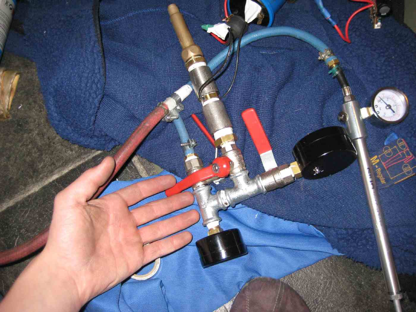

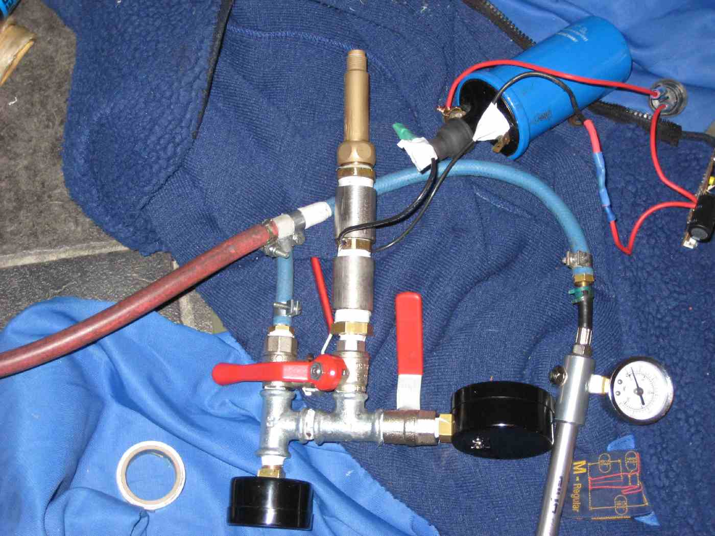

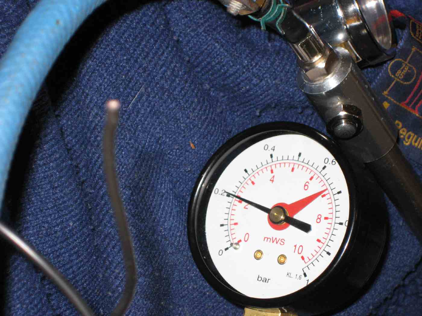

attention: this is a small gun i threw together to test the meter before i go full scale. but it is a fun little toy.
Chamber: two 1/2" hydraulic couplings
Barrel: something i took from a regulator
Mix: i have used 5x (first shot :D ) but i am going to 11x
Material, chamber: two 1/2" brass nipples and two 1/2" stainless couplings
Ignition: the good old camera cap dumped into a coil
Spark gap: 7mm but i think it takes the shorter way into the walls when it has 5x more resistance
Burst disk holder: i made it myself, works better than a union
i did not make this to turn out good or look pretty, as said the only reason i made it was to test the meter.
sorry for the mess on the pics, the cloth is there to hold Larda scratch free, and it is a good place to sit screwing fittings into eachother
DYI: you wasted your money. my gauge cost $20 and works after it got a 5x on it when i left the valve open :oops:
so do you guys have some feedback?

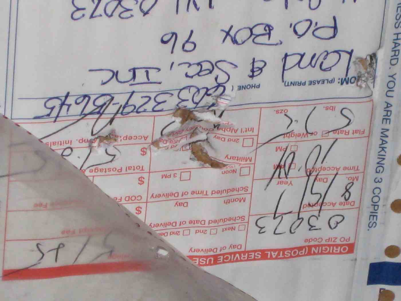

"damage" all shots taken with wet tape balls (loud)
"damage"
"damage"
my cheap ass gauge (1-15psi)

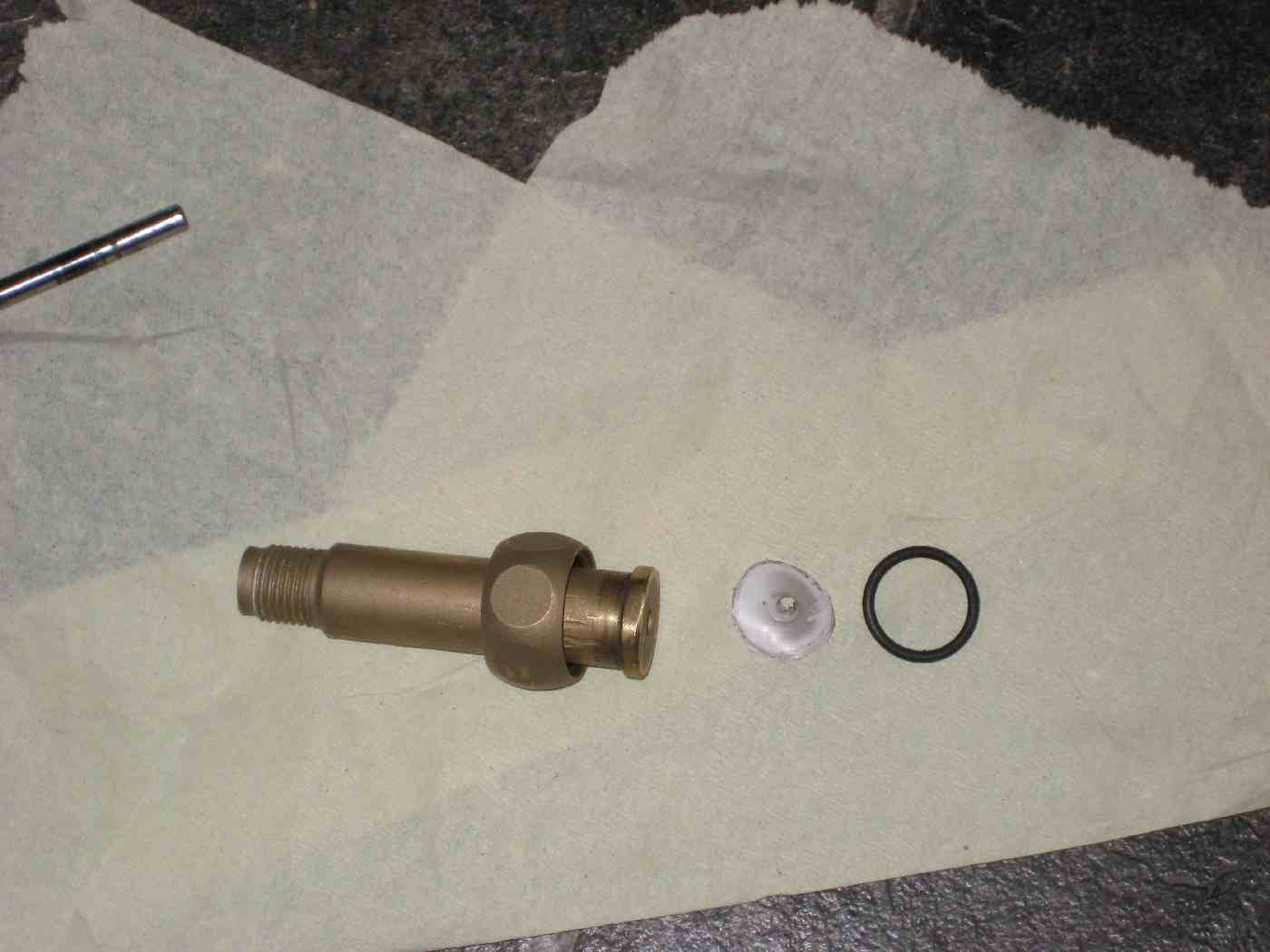

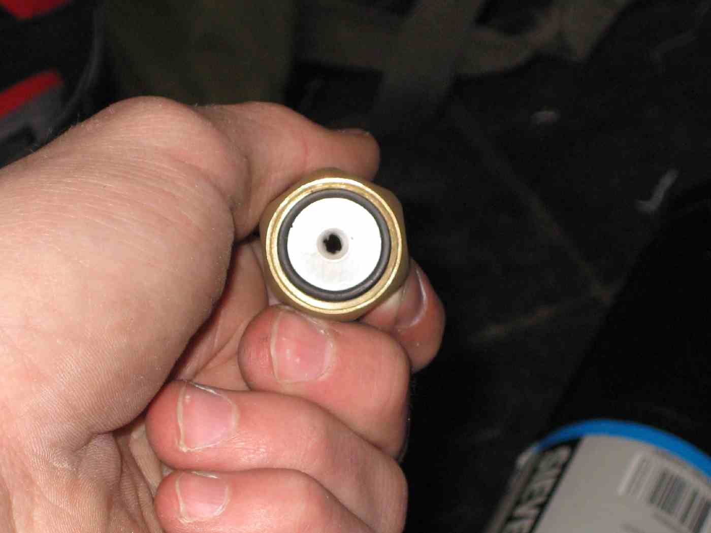

the simple burst disk setup

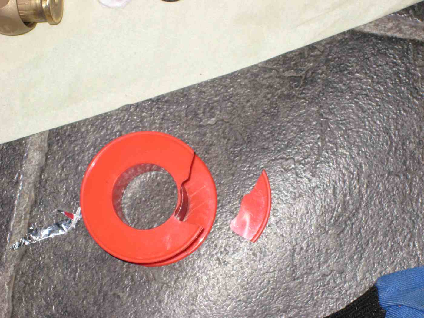

burst disk after a 5x

The reason your gauge probably didnt break was that it reacted too slow for the pressure peak.

i also put the 60psi of pre ignition pressure on it.

Good job SpudFarm. And I didn't waste my money on the gauges. They allow me this wonderful thing called "repeatability" that your setup will never achieve :P

hehe yes they do if you tap them carefully it fires every time, (but sometimes i put in to much propane in there because of the size)
but all in all the meter came out more compact than i thought it would. now i need one more 1/4" nipple to change out the hose TEE to galvanized :)
after that i have to make the sparkstrip and i can shoot :D
