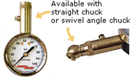

Thanks for the info guys. - Some I understood, some went over my head.
I think I found what I was looking for though.
Here is the add:
Accu-Gage® S... Series Tire Gauges
Tire gauge holds pressure reading until released. Pushbutton release bleeds air to desired tire pressure. Steel case. Optional rubber guard protects gauge. 15*, 30, 60, 100, or 160 max psi tire gauge
I am going to look for it local so I can spy the threads and then order if I can't find, and take my chances.
Once I get it working I'll post some results.
Here is the add:

Deadeye:
I'm not sure if that gauge will give you the information you want. The problem is that when it pressurizes the gases in the gauge will heat up, even if none of the combustion gases actually make it into the gauge. The check valve then closes. The hot gases cool. The pressure drops.
You may hve to fire the gun repetively, without reseting the gauge, to get an accurate reading. Basically, the protocol that psycix suggest.
You will have to fire it multiple times anyways since one particular reading is never enough to be sure. Always use the average from multiple readings.

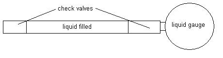

What about using a liquid to measure the pressure? Here is a simple sketch of what I mean.
The hot gases from the chamber will put pressure on the liquid and force it into the gauge. The check valves are there to keep the pressure on the gauge.
Of course there would need to be a way of bleeding the gauge, but...well, if needed, I can put more thought into this for bleeding purposes and such.
- untitled.JPG (7.4 KiB) Viewed 3676 times
