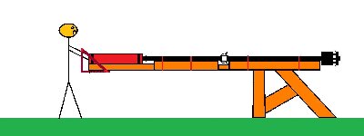

well simple question put difficult:
whan dealing with loads of recoil, does the chamber generate some of the recoil or just the part of the barrel that has the projectile in it?
i am planning to support the hybrid on only the barrel on my bipod and wonders if it is going to treat normally so the chamber does not tear my bad brass union.
thanks!

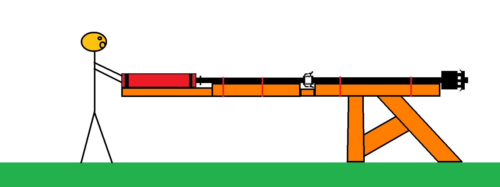

look at the diagram while reading this:
the gun is only mounted to the bipod on the barrel (hose clams), on the chamber side (everything that is not mounted is) chamber, 2" brass nipple, 2" steel copuling, 2" by 8" steel pipe nipple and 2" female x female brass union. i does this because when i am changing disk the chamber can rest on the wood under it so no lifting/dragging is needed that can damage gauges and stuff.
it WILL kill me if it loosen.
(note, i will only hold it with projectiles under 140grams)

Like i said, if your design is linear as the picture shows, the endcap of the CHAMBER will experience the recoil. With the barrel clamped, EVERY fitting of the gun will be subjected to EVERY bit of recoil force. If your goal is to avoid stressing these parts, clamp the chamber down and take the barrel off to change disks. You'll probably want to screw a block down behind the chamber as well so that you're not relying solely on hose clamps.

hi clide, i does understand what you are trying to say.
but i think i got a idea that can help safety..
a steel plate bolted TIGHTLY to the 2 x 4" under the back of the chamber then have square steel welded in an angle upwards and backwards from the plate so it stopps in the height of the highest point of the chamber and then have a 1/2" plate welded there again (diagram LOOK FIRST THEN READ A BIT AND LOOK AND REPEAT!!)
