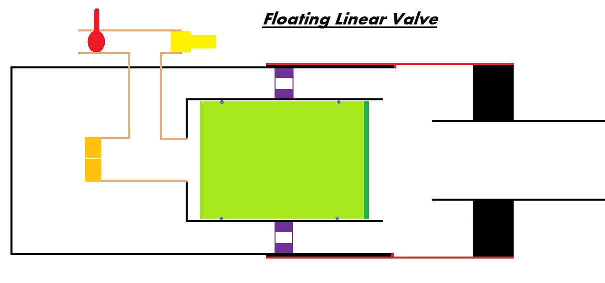

This won't work, you have to have pressure pushing the piston back, and in your design you have the front of the piston sealed off. I think your best bet would be a coaxial, as it is pretty similar to your design. The only bad part about a coaxial is that the barrel has to be smaller than your chamber.
I pretty much had the same idea, except mine will work. :wink:
I can't be bothered finding the topic but here's a diagram:
Edit: That's an old drawing, can't find the new one. The advantage of the new one is that it's assembled inside a coupler and uses two halves of a bushing on the bottom to support the piston housing. Allowing more flow then this diagram.
Linear piston.jpg (39.08 KiB) Viewed 4510 times

I see what you mean now about not having pressure on the face of the piston; I had considered that but didn't know how much it mattered. I thought about simply sanding the sealing surface into more of a shallow cone shape, rather than one that was completely flat; this would allow some force on the piston surface. Otherwise a pull spring would do the job too.
The concept that man-o-war used occurred to me too, with the piston being on the barrel side and getting pushed straight back upon actuation (picture my drawing backwards), but I decided not to go that route since it would have required an extra o-ring. I would think that it would actuate extremely fast though.
I had been leaning towards a coax for a while, but they're always fatter by nature, and they don't lend themselves to fast breech loaders as well, especially with an odd-shaped projectile like a nerf. I've only thought of one design that would work, but I would have to basically fabricate a bunch of pieces by hand and weld them all together (I'm a full-time welder by trade)... cool, just not what I want to do with this one. Thanks for all the constructive advice so far guys.

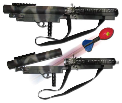

biged
Posts: 99
Joined: Sat Jun 09, 2007 8:06 am
Pipes, washers and a welder.
This is a pic of 3" piston that's in the 4.2 mortar. It's the same design that is in the bazooka, except that the bazooka is a 2".
Here's a set of "nerf" internals that will fit inside a demill AT4. They were designed for a m72 law but they were too large. I am reworking the design for the law so that the barrel can also collapse and extend.

nice piston design... but i still prefer coaxials :wink: (mainly because a muzzle loader is less threatening)
