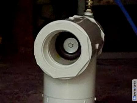

Before you try more neoprene, take a look at your washer.
Now, take a look at the washer on a Supah Valve.
Much bigger, right?
If you have too small of a washer, it will allow too much air to get under the piston between the edges of the washer and the edges of the barrel, which will forces the edges of the neoprene into the barrel.
Try a bigger washer. It should be as big as possible (maybe a 1/4" maximum space on the edges between it and the sealing face). Of course, you said your sealing face was square, so this changes things a bit. By the way, how the hell did you manage to get a square sealing face???
EDIT - and here is a picture snapped from a video Velocity made about his AmeriCannon. You can see that the washer is pretty large, and you can also see clearly the bulging of the neoprene around in, where air is getting under it. If the washer were too small, the neoprene would pop-up into the barrel.

- AmeriCannon Sealing Face
- amurcannon.jpg (13.25 KiB) Viewed 3543 times

I used McMaster Part# 9013K262 for the rubber sealing face on the Americannon. It is expensive at $15 for only a square foot, but it works...never had a sealing problem. It is also extremely durable (for spudgunning uses).
You can get some nice big washers off of McMaster.com as well...I used a washer that was 1.25" in diameter, but I still had problems in terms of the rubber sealing face popping out. I bought 2.5" washers subsequently, which work great.

Just about any kind of rubber will work as long as the washer is all most the inside diameter as you barrel, leaving only the barrel wall thickness amount to do the sealing. That tiny washer holding down the large area down will never hold.
