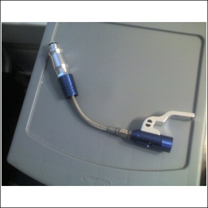

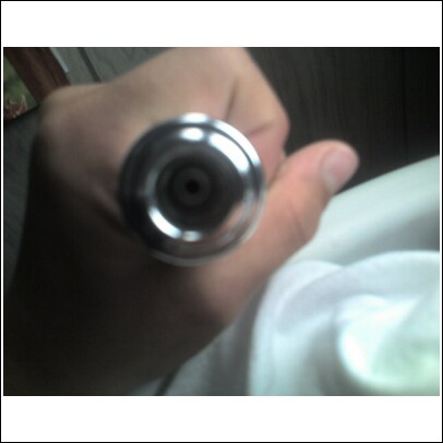

I am making a cloud bbmg and i am wondering if i take the Co2 part of a paintball gun and adapt it into the loading tube.. will it lift the bbs up just like air will.. i am giving pictures of what it looks like..

So instead of an air feed, you feed it with a CO2 supply?
Possible, but there are some drawbacks:
-Cost. A BBMG is VERY inefficient and wastes are like no other. This makes CO2 expensive and rather impracticable.
-Safety. Unregulated CO2 will create up to 800psi, which can blow up most chambers. Make sure to regulate it and seriously spend a few bucks on that popoff valve.
-Temperature. Also a point of safety. The cold CO2 freezes stuff up sometimes, which makes things brittle.
The only good point of using CO2 would be:
-Free portability
-Free portability
- ALIHISGREAT
- Staff Sergeant 3
- Posts: 1778
- Location: UK
maybe you would need to ditch PVC for this project and get a regulator too.... i would reccomend pressure rated ABS if you can get it as it doesn;t become brittle with the cold and it doesn;t shatter either.
