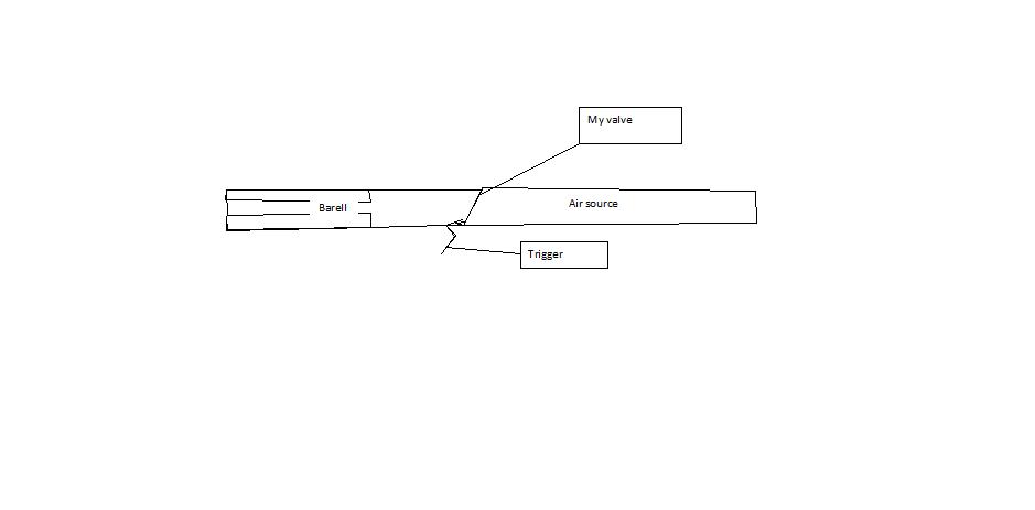

i am trying to build a rather strong accurate air powered pellet gun. i have pretty much access to nearly no materials here in switzerland. i will make a gun stock from woad and i want to ty to make the gun look real. i developed a trigger system (i included a diagram). my only problem is the air source i want to have several shots befor ehaving to fill up the air tank. on the other hand i do not want to spend money for a big compressor nor do i want to carry around a huge heavy 500psi tank or nything. plese give me some advice.

i think i now managed to post the diagram
- this is the diagram, i know its not very good so email me with questions
- valve.jpg (13.37 KiB) Viewed 4503 times

the thing about the ball valve is that i dont like the speed it opens at, ccurate means i can hit a target the size of a coke can from 50meters. i have made bullets and pellets before, thats not my problem. i want to use a smooth bore because it is impossible to get a rifled barrel here with out the police tracking you down. CO2 is a problem i can get it but ist really expensive(500 to 800$ for the bottle plus regulator and only 50bar preasure). for any other pressurized gasses i need a licence.paintball is also problematic in switzerland you need to register any paintball guns you own, have to own a liecence and have to be other 18 so i will not be able to get co2 from there i hope thats info helps. the valve i desighned is supposed to open extremly fast. it will be made up of a peice of metal of the exact diameter of the barrrel but will be a bit longer at the bottom part so it is diagnal wehn in the barrel. it will have a hinge at the top end. at the bottom end of this peice of metal will be a little extension which will hook up to the trigger. when the trigger is pulled the air presure will push the piece of metal up and go into the barrel to shoot the pellet.

I didn't mean to use a ball valve as the main valve.
I meant to use the ball valve for filling the chamber of the gun, a piston valve would be my choice for the main valve.
As Jack says, if you give up the multiple shots per fill part, things become much simpler (and less costly).
Pressure is key, and those 12v compressors will not be nearly as good as a shock pump or home made stirrup pump. (or fridge compressor and storage tank

I don't think you truly understand what you are asking for. But here goes.
Multiple shots per fill can be accomplished in a couple of ways.
1) Pressure tank separated from the chamber by a valve. Open the valve to charge the chamber, then close the valve to isolate the pressure tank. Repeat for each shot. Use a piston valve for the main valve of the gun. (this is what I suggested on my first post)
2) Hammer valve. This is a valve which "dumps" a certain amount of air from a pressure tank/reservoir behind the projectile. It is more complex than a piston valve, and requires several accurately made moving parts.
3) BBMG. Dump air through a vortex block, it pushes bb's out of the barrel. Low power, but very high rate of fire, coupled with a very high rate of air consumption.
If you click on my sig at the bottom of this post, you can see some of what is involved in a hammer valve and trigger mechanism.
What tools do you have access to?
