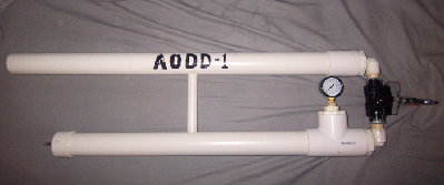

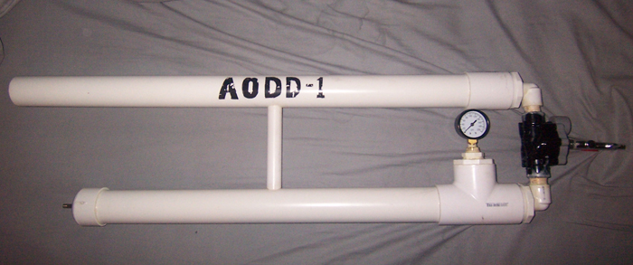

heres a pic, the gap between the barrel looks bigger in the pic than it really is, and i might make some ammo holders or something similar to sit in there.

looks good to me. You probably jsut werent getting enough flow with the selenoid.
And that sprinkler valve is choking the flow quite a bit but it should hurt you too bad. C:B looks pretty good too.
