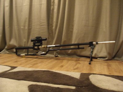

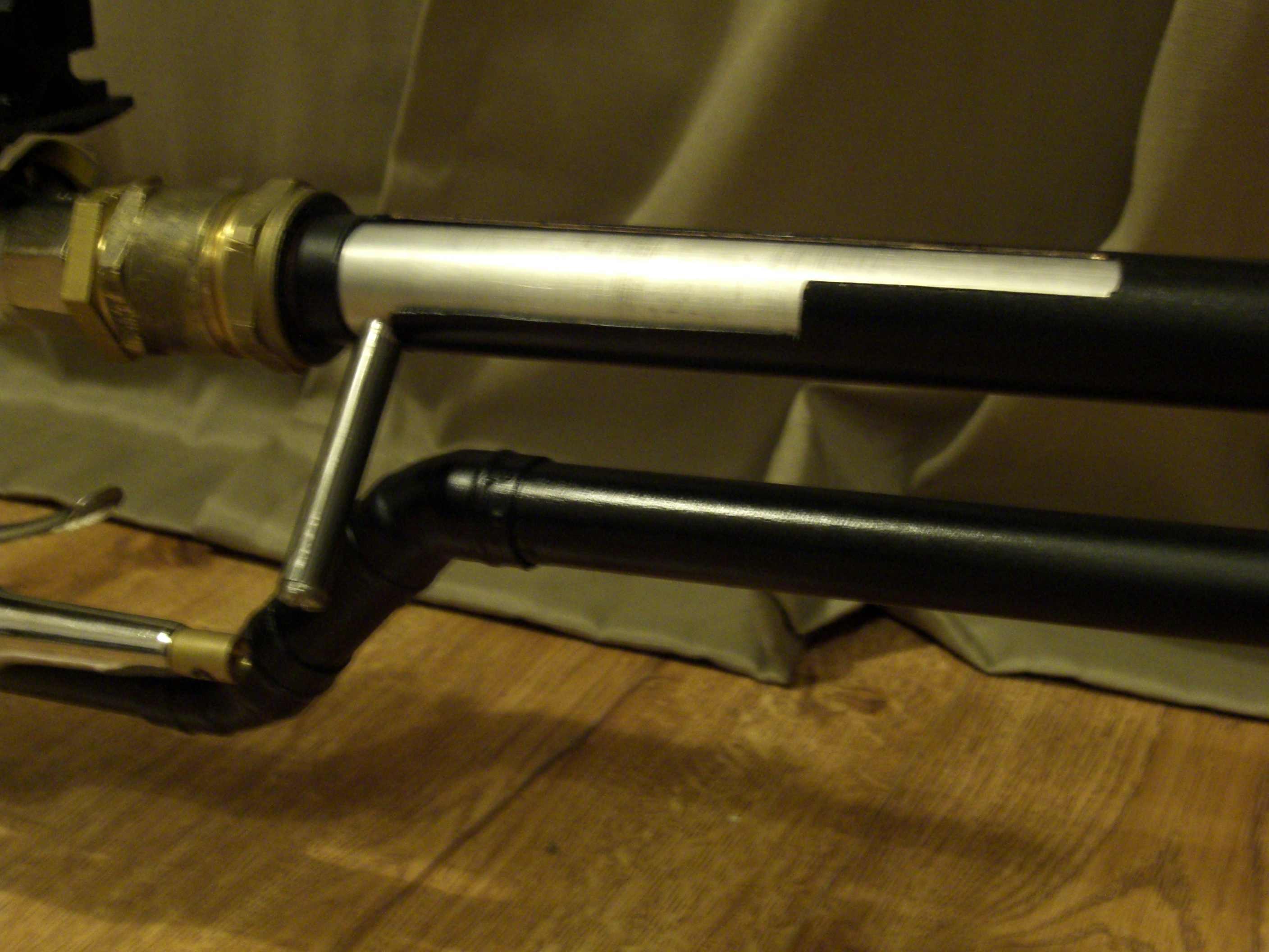

Hi, I'm new here so I Thought I'd introduce myself with some of my work before bombarding people with questions. I put this together about a year ago so you won't see any state of the art cannonage here, but it's not a bad performing pneumatic, some people might have seen this before on UKSGC.
Gun stats
Chamber: 22mm copper
barrel: 1" thick walled aluminium
valve: 3/4" QEV
operating pressure :150psi
One of the more interesting features is the breach loader, I have managed to avoid the use of a pipe clip in here by using a thick walled barrel and threading the bolt directly into it.
the suppressor also works and probably took longer to built than the rest of the cannon put together, it can be screwed on and off of the barrel.
Finally, Ive been lurking around here long enough to know you guys like some damage pics, enjoy :)
http://uk.youtube.com/watch?v=0m52-bVbNJc

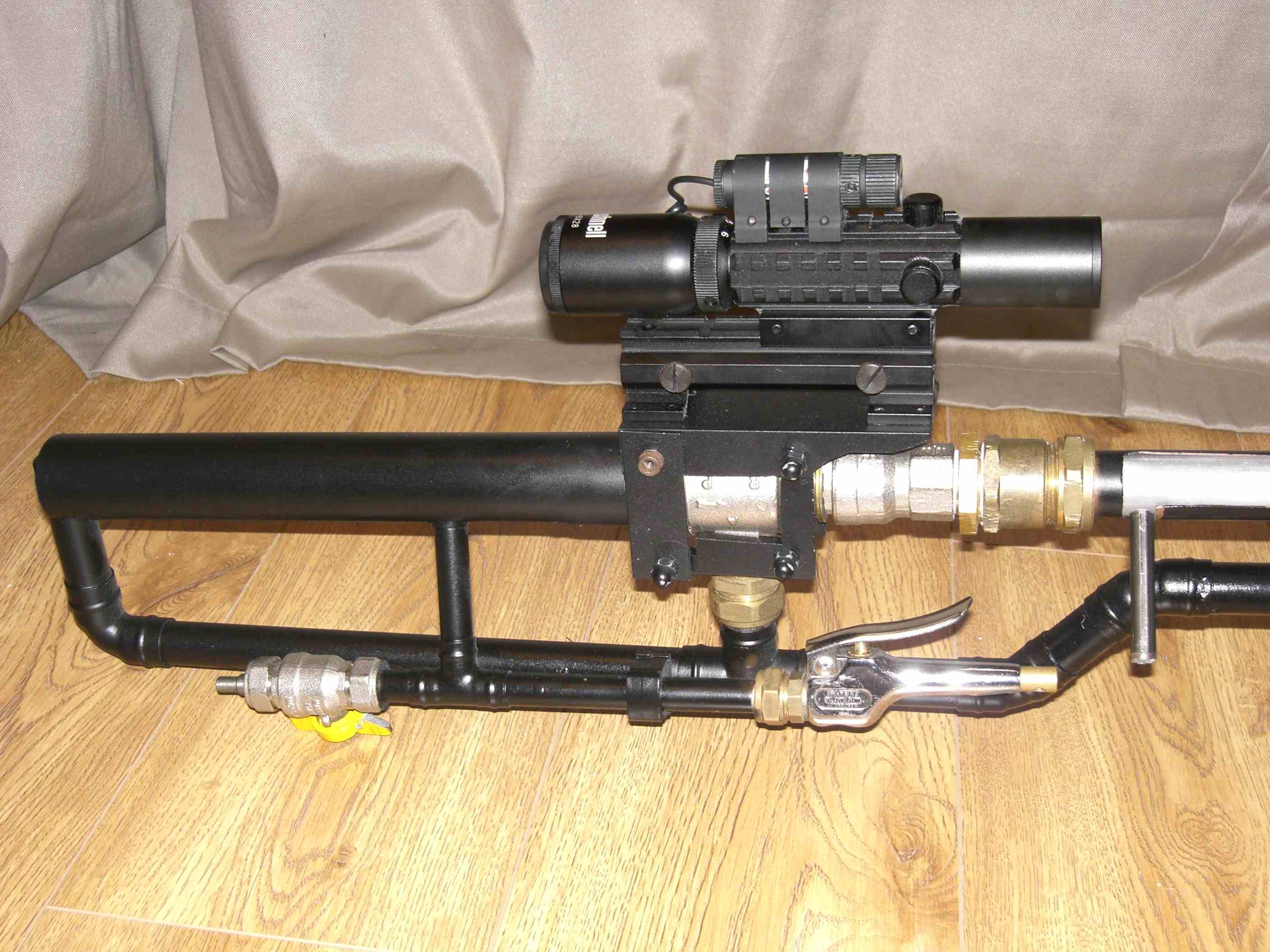

pilot setup
pilot setup

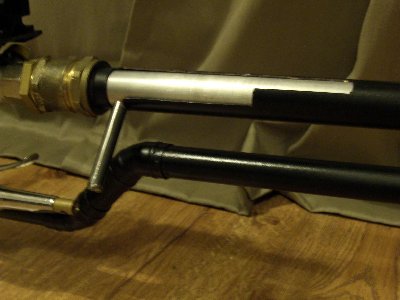

breech closed
breech closed

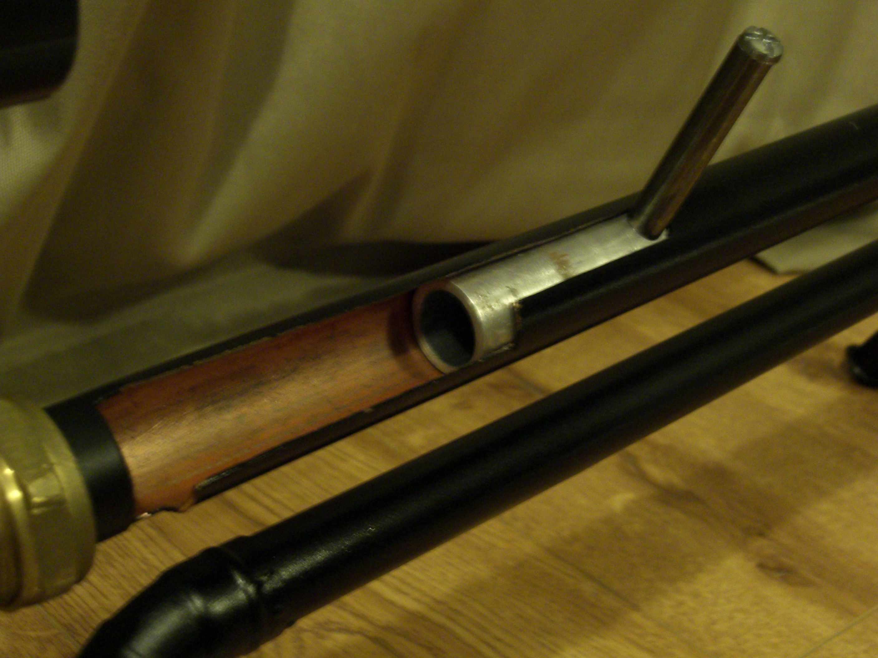

breech open
breech open

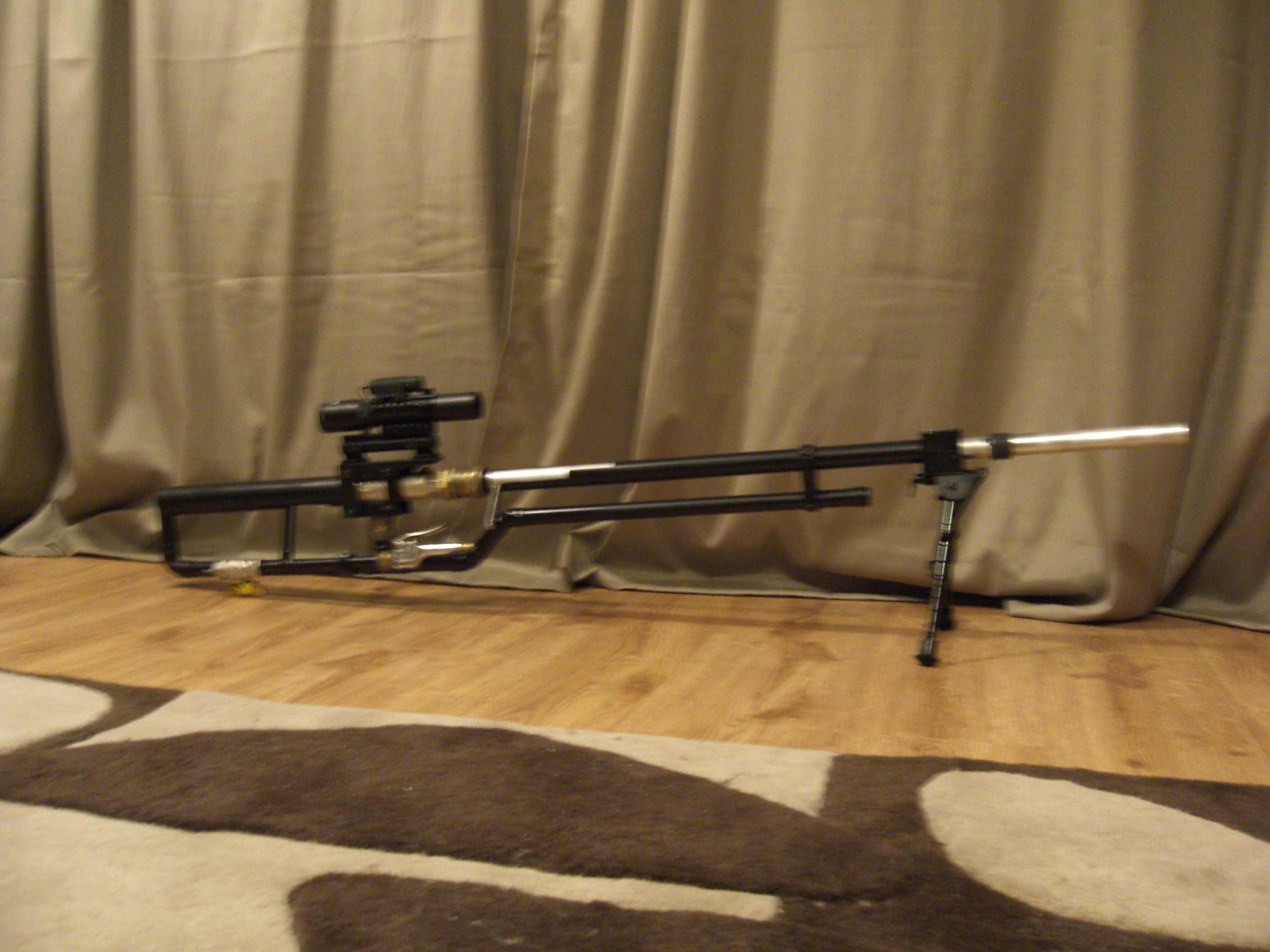

suppressor removed
suppressor removed

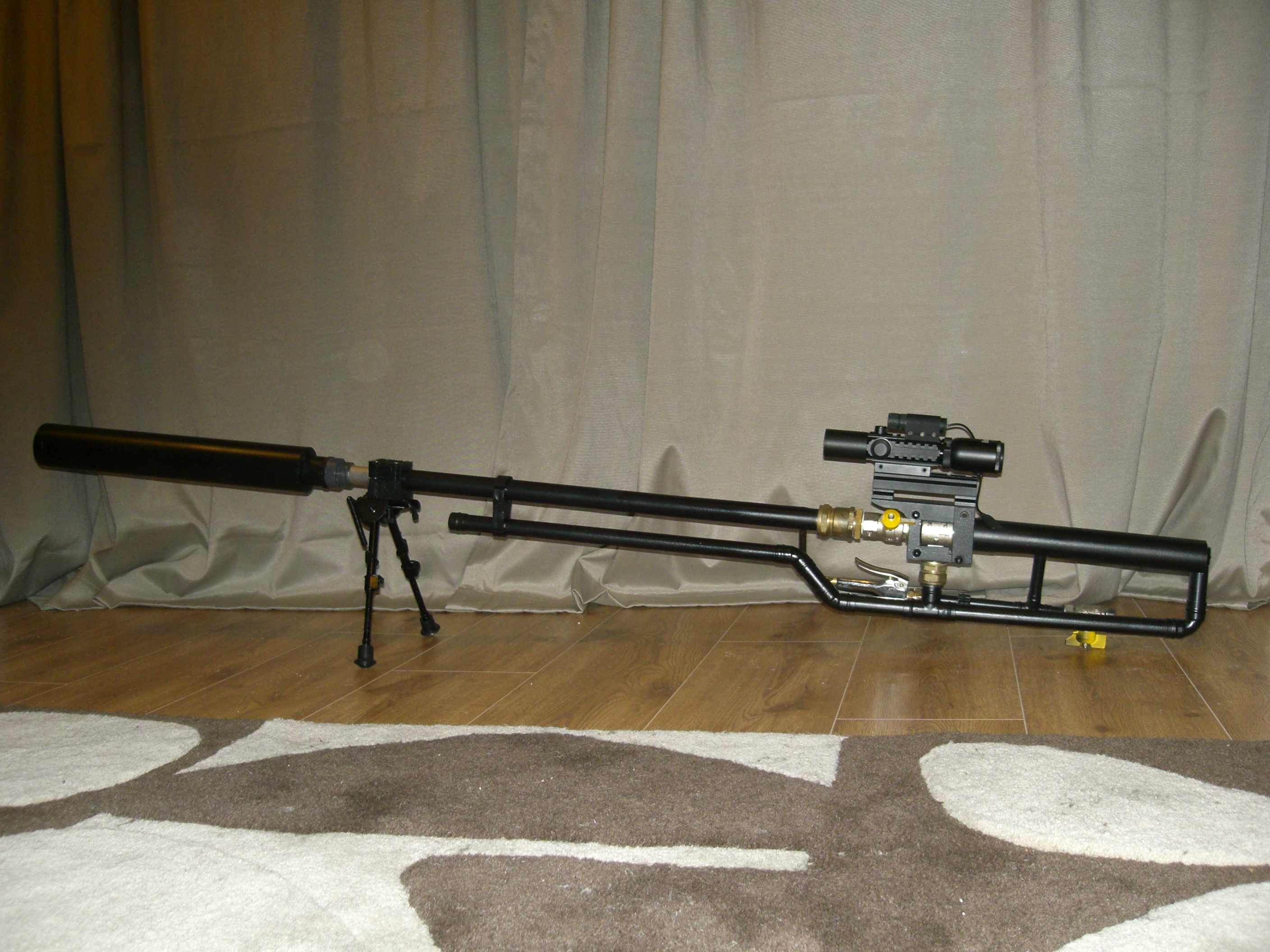

cannon, with suppressor attached

Thanks, I'm a fan of bullpups myself, ok this isn't a real pullpup but the stock is fairly useful, being half of my chamber.
Poland_spud, I agree, the only thing that might cause problems would be the crappy blowgun but that needs replacing anyway. Unfortunately I currently have no way of getting up to 300 psi.

how did u conect ur bolt to ur barrel?
