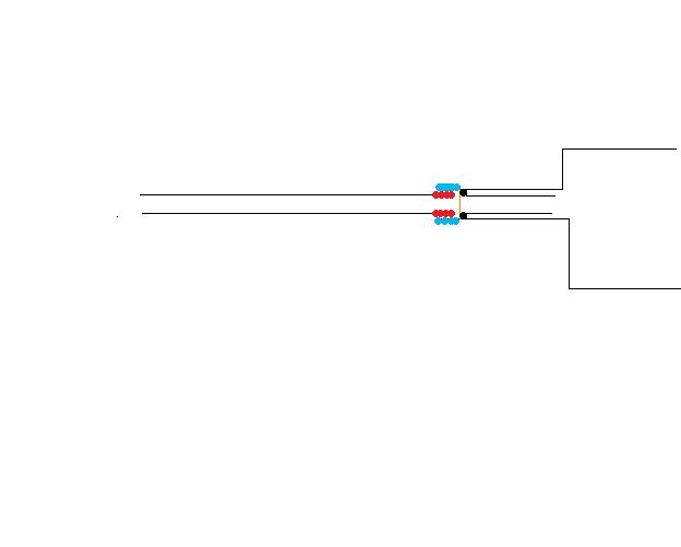

look at the little diagram i quickly drew, it is simple but it should work.
blue: female thread<br />black:O-ring<br />Little red line: Burst disc<br />red: male thread
blue: female thread
black:O-ring
red: male thread
burst disc idea.jpg (8.68 KiB) Viewed 2504 times
