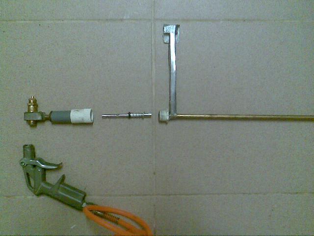

I (sort of) has full auto :D
Following on from this experimentation, I cobbled together a functioning setup just to at least prove that the concept is workable. It's all very ghetto and would need a bit of fine tuning to be reliable, but as you can see from the last video, the power potential at the 110 or so psi I'm limited to makes it just not worthwhile. I did develop a fondness for pop-offs however so there is a little idea that I might be revisiting :) In the meantime, enjoy some videos and a pic of the dismantled unit.

So tell me if im wrong its like a mini piston with the pop of as the pilot valve?

dudeman508 wrote:So tell me if im wrong its like a mini piston with the pop of as the pilot valve?
You are in fact wrong, there's no mini piston - the pop-off valve is the firing valve, and exhausts into the breech.

So this is a blow-forward bolt together with a pop-off?
At what pressure does this popoff open, and on what pressure does it close?
(most popoffs close at a different pressure then they open, which allows you to do stuff like this)
You just put full flow trough the blowgun, or is there a restriction built in?

psycix wrote:So this is a blow-forward bolt together with a pop-off?
That's it, I used the variation suggested by ilovetoblowthingsup for smoother operation
It depends on how you tweak it, as it is the setup doesn't work below 75 psi.
There has to be a restriction, otherwise the pop-off will stay open. The setup needs to be like this:
air supply -> restriction -> firing chamber -> pop-off valve
This way, when the firing chamber reaches firing pressure, the pop-off dumps pressure then closes, allowing the firing chamber to fill up again, getting up to pressure and so the cycle repeats. You can change rate of fire by varying this restriction, less restriction means greater rate of fire. Removing the restriction gives you a rate of fire of "infinity", so to speak, as the the valve will stay open as long as there is air supply.
In this case, the "firing chamber" is the hose between the blowgun and the compressor, while the restriction is the compressor's tap.

I don't plan on developing this any further, the idea now is to build a pop-off actuated piston valve and combine it with a cartridge feed system (or just direct blowback if I'm feeling lazy :roll: ) - still, anyone who wants a low powered full auto airsoft MG has a basis for some development with this design, which has lots of room for improvement like:
