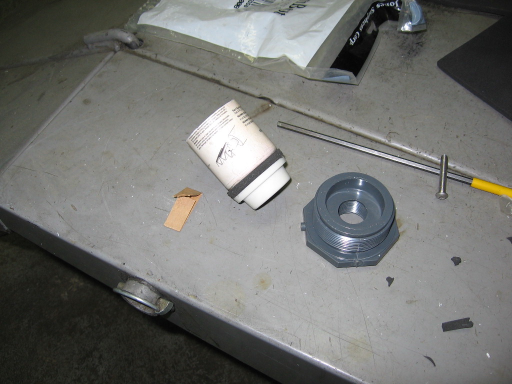

if you are attaching to the piston, the little rubber doorknob bumbers work great.... like this...[/img]
it works on any piston 2" or larger...

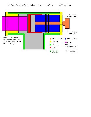

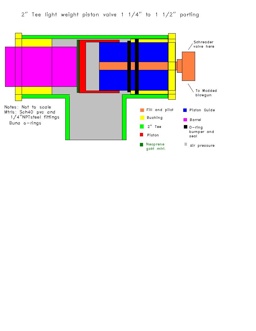

I've used neoprene sheet (copper guns) and a buna o-ring for bumpers.
Several hundred shots through the copper guns and my pvc gun, with no signs of failure.
