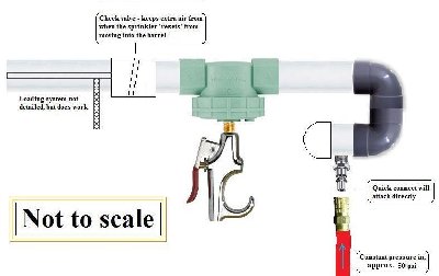

I don't think I have posted this yet (if I have, please correct me). After taking a short break from spudding and then tinkering around a little bit, I have a few new ideas. This is one of them.
(check valve can be built or bought at Ace)
original Semi-auto idea

Essentially, everyone who has built a sprinkler valve cannon has done this. Aside from the hopper, which most people don't bother with.
The check valve isn't needed and restricts flow by the way.
But nice that you're thinking of ideas

Actually, I disagree with the check valve part. In my current cannon I use a 1/2inch barrel and the 'reset' valve air is strong enough to propel a 25gram shot about 2 feet (the shot even has 1/8inch space inside the barrel).

Try having the air input right next to the sprinkler or better yet, mounted on the sprinkler valve.
The check valve will limit flow unless you get like a 1" one, even then I wouldn't be sure. And they get pretty expensive that size, well atleast here they do.
Another thing would be to swap the spring for a stronger one, not sure what effect that would have on performance though. You could also make the equalization hole bigger, same thing for performance though. Someone should tests these things.

Well thats what I'm looking at doing. After all, what's spudding if not that?
And yes I will use a 1", its only about $7.

Basically, yes. As long as I replace the spring (as mentioned before) it shouldn't be a problem.

You are probably right (as most on this site probably know more about pneumatics than I do), but to be honest I'm not exactly sure what your idea would accomplish....?

Enlarging the equalization hole would hopefully make the diaphragm seat quicker, meaning less air is expelling through the barrel.
Strengthening the spring hopefully would keep the diaphragm seated for longer when you are filling up the chamber. Since more force is on the diaphragm, it is kept down, and sealed, longer, allowing the pilot volume to fill as well. This also should help keep expelled air to a minimum.
There shouldn't be any negative side effects that would notice to these mods, though they may take some fine tuning. You can always try the check valve out first, if it doesn't work as well as planned, maybe try these mods.

Aha, now I understand. Thanks, i will def. give those a shot if the check valve doesn't work. I'd love to try them, its simply a matter of time*effort. Thanks!

I could, except that this is supposed to be semi-automatic, and that would require more effort than simply pulling a 'trigger'.

making a fill system for a semi auto should not be a problem, there are ways of doing this setup already, the loading setup is the only place that need new designs,
here one way to setup a sprinkler valve:
http://www.spudfiles.com/forums/true-semi-t156.html
that's one way to make the diaphragm reset quickly,
strengthening the spring would decrease performance because the spring tension hampers the diaphragm opening even if the effect is small.
the only method that doesn't hamper shooting performance is filling from the pilot, in fact this will allow you to remove the spring and increase shooting performance the best way to do this is to buy a QEV and a 3way valve. the downfall is that the fill rate may decrease which is just a problem on sprinkler valves, but you can improve it by increasing equalization flow which I did by cutting a flap in the diaphragm, adding a line with a check valve between the pilot and the chamber should increase flow enough that it won't be a problem, you can also see what I did with the deus ex machina
http://www.spudfiles.com/forums/deus-ex ... t7864.html
http://www.spudfiles.com/forums/deus-ex ... t8418.html
the valve used (http://www.spudfiles.com/forums/semi-blowgun-t6877.html) note that it's very weak and should be done if you can't or won't get a better 3way valve
