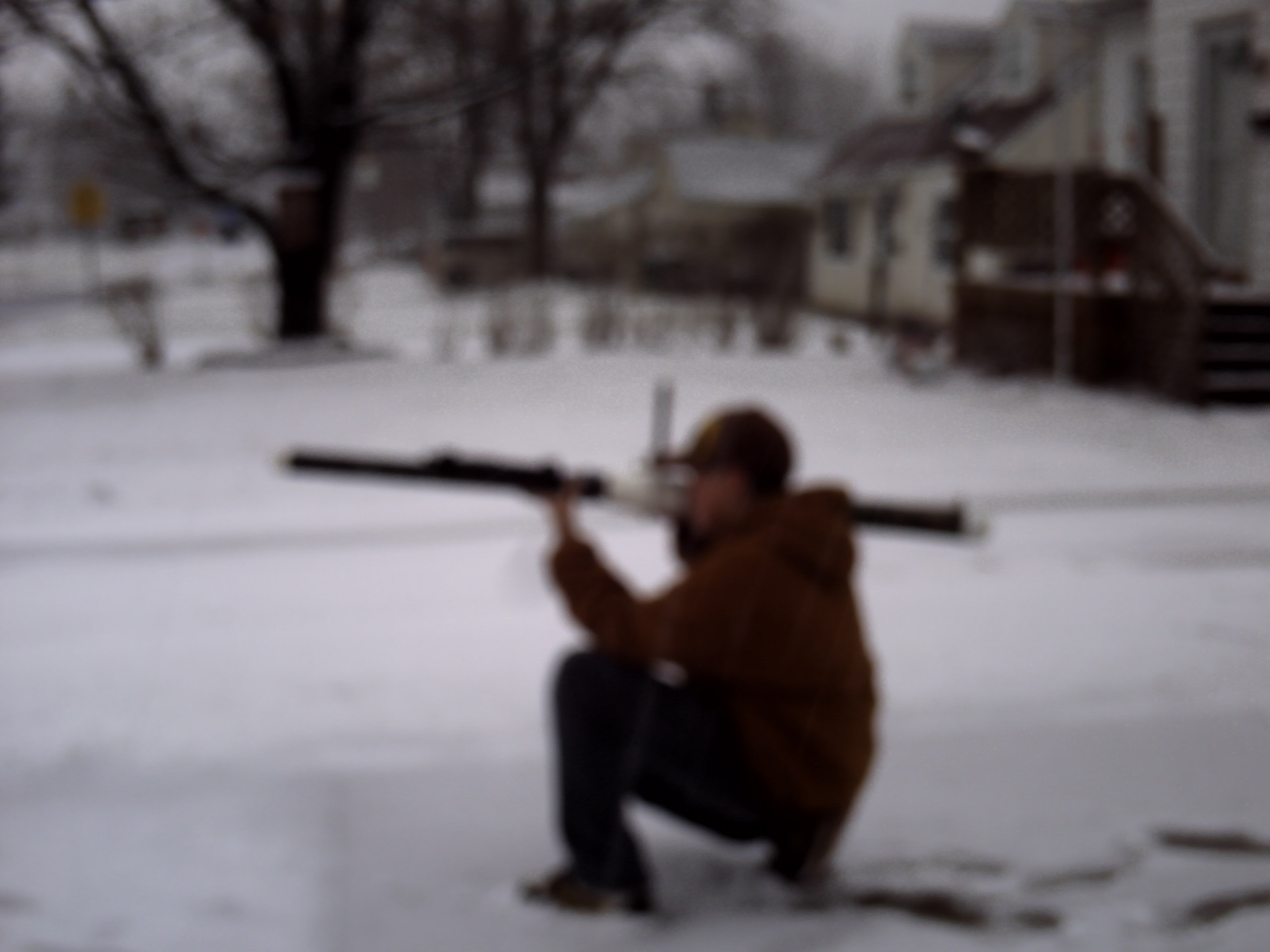

pneumatic airsfot cannon camo & tri rail

ALRIGHT GOT IT ILL TAKE COMMENTS OR CRITIQUE!

with the cannon
with the cannon

Any chance of a better picture?
You really cannot see anything in that one.
maverik94
Posts: 558
yeah, a clearer pic would be nice

got it now its goin so whachya think

PVC in winter, bad call, can you say plastic shrapnel?

if u go to youtube put in my username snobum101 you can see this in high quality which is much better

that's what 3 layers of duct tape r for and im using a hand pump which would be shrapnel way before the cannon and 1 more safety measure the end which would blow of before explosion.

Duct tape will not contain an explosion, not by a long shot, thats like wraping duct tape around a pipe bomb, it will do nothing.
The pump, unless it is plastic, which I doubt because I have never seen a plastic stirrup pump, will not turn to shrapnel.
And the end cap, how do you plan for that to pop off? that does not sound like a safety measure to me... sounds like something that unless you have tested, in which case I would tell you to throw that gun away because it is throwing unpredictable pieces everywhere, then it cannot be counted on as a safety measure.

it was loose snow and if thissafety measure is a problem im sorry but its had a 100 or more shots through and no problem the pressusre rating is 150 i only use 45 psi the valve has a 150 rating butthe actual chamber has a rating of 275 so in my own rights id say im completely safe

I would definitely stick a modded sprinkler valve on there instead of a ball valve, its way faster and easier to pull. Seems a waste to have your "tri-rail" thing then only use a ball valve.
it wont explode because the rating is lower that the pressure you are using it will explode because pvc gets really brittle in the cold wich causes explosions.
