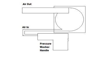

I would say yes it is possible, but do not take the vortex block route, If you really just want automatic marble gun, I would use the popoff piloted QEV method, it does not require such a massive air supply, is much more efficient.

Ok, well it is essentially just a normal marble gun, think just air tank, QEV, and barrel,
Now, instead of a blowgun on the QEV, theres a popoff valve, so when it reaches a certain pressure, a blast of air, so as long as it is on contsant air, it will fire automatically.
Then, on the barrel, just add a T with a magasine on it, and in the T, just a little paddle behind the marbles that when the gun is fired, it flips up and blocks more marbles from firing.
Pretty simple, but effective, all you have to do is be sure you have the popoff moded to just below whatever your operating pressure is.

My vortex design:
Edit: I know its not good, and I could do what you said but my dad said we might be getting a new compressor (35 Gallon).
- Vortex Marble.jpg (6.38 KiB) Viewed 5634 times

Where would I get a qev?
