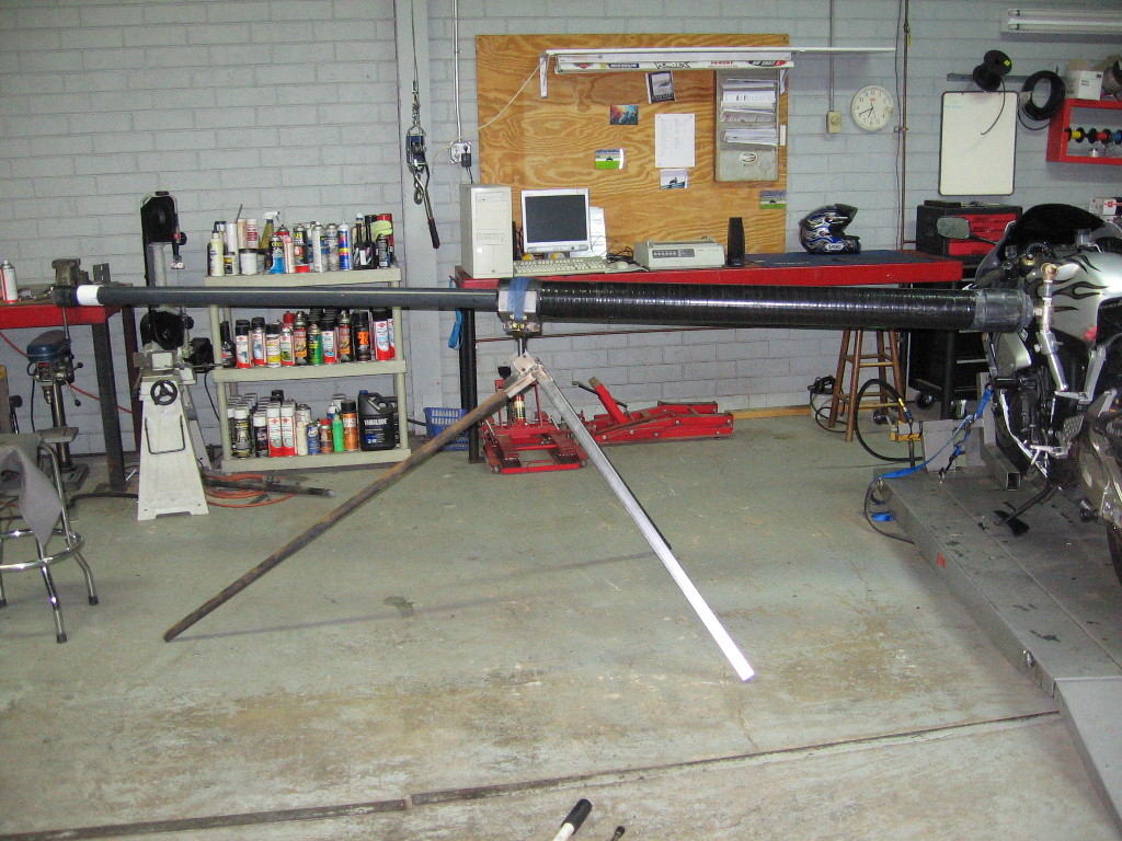

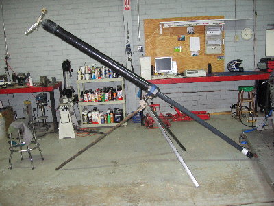

I figured since it is a GB gun, might as well use a Golf referance to name it...
The only thing left is to paint the tripod and put a Ping sticker on it...
It's a 4"x56" chamber SDR21 sleeved into sch80, 114" barrel length...
The chamber is overlaid in black cloth duct tape, spiral wrapped with a 1/2 overlap, and then taped linearly with 1/2 overlap, and then another spiral wrap half overlap going the other direction, the tape is 6 layers thick at any one point... The overlay serves 3 purposes, 1. protect the chamber from dings and scratches, 2. Help to keep the chamber from swelling under pressure, 3. in case, Heaven Forbid, there's a catastrophic chamber failure it will keep schrapnel to a minimum, and 4. It looks really cool!!!

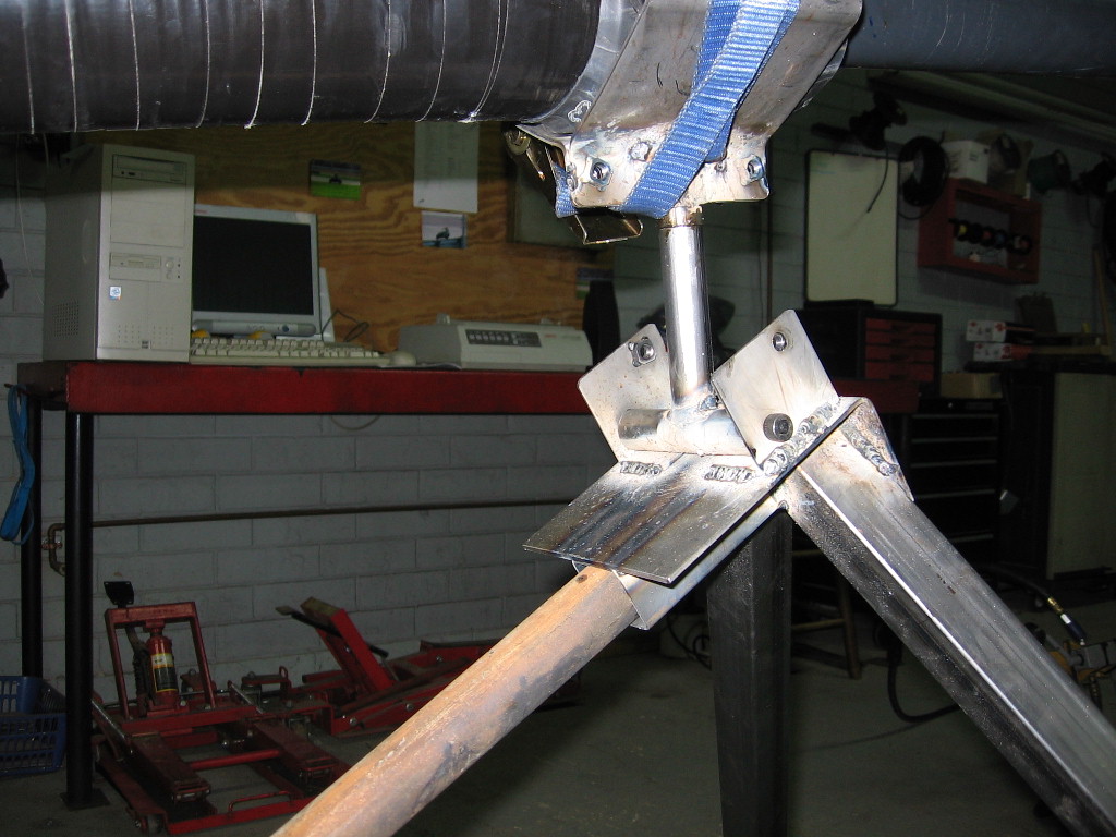

Some pics you've seen, but this one is with the tripod I just completed... it has full up/down and side to side movement, it'll even spin 360 degrees...

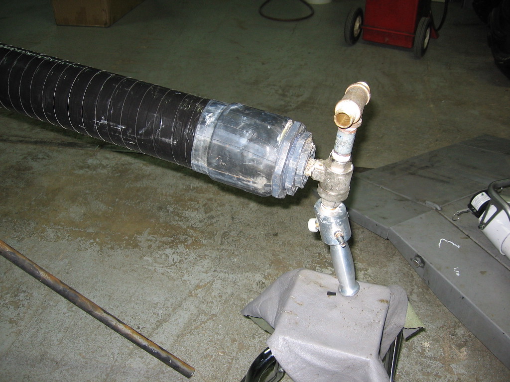

Some may notice the handle/trigger mechanism, it was canabalized from a pneumatic tire bead seater, you keep the supply line hooked up and all you have to do is squeeze the trigger to fill(about 4sec. with a large compressor) and release to fire, but it actually fills/pilots a 3/4" qev....
Whatcha think??? Other than the lighting in the pic sux...
I'll try to get some better pics up soon, with more detail on the trigger/handle....

It looks okay, very basic, but extremely powerful and large.
I mean..A coax's a coax.. not much you can do lookswise.
The tripod adds to the coolness, and no doubt, handling.
Hard to see what you've done to the pilot.I'd love to know more.

the rear leg is removable for transport...
and the2 barrels on the floor are the 3" barrel, and 2" barrel for the modgun...

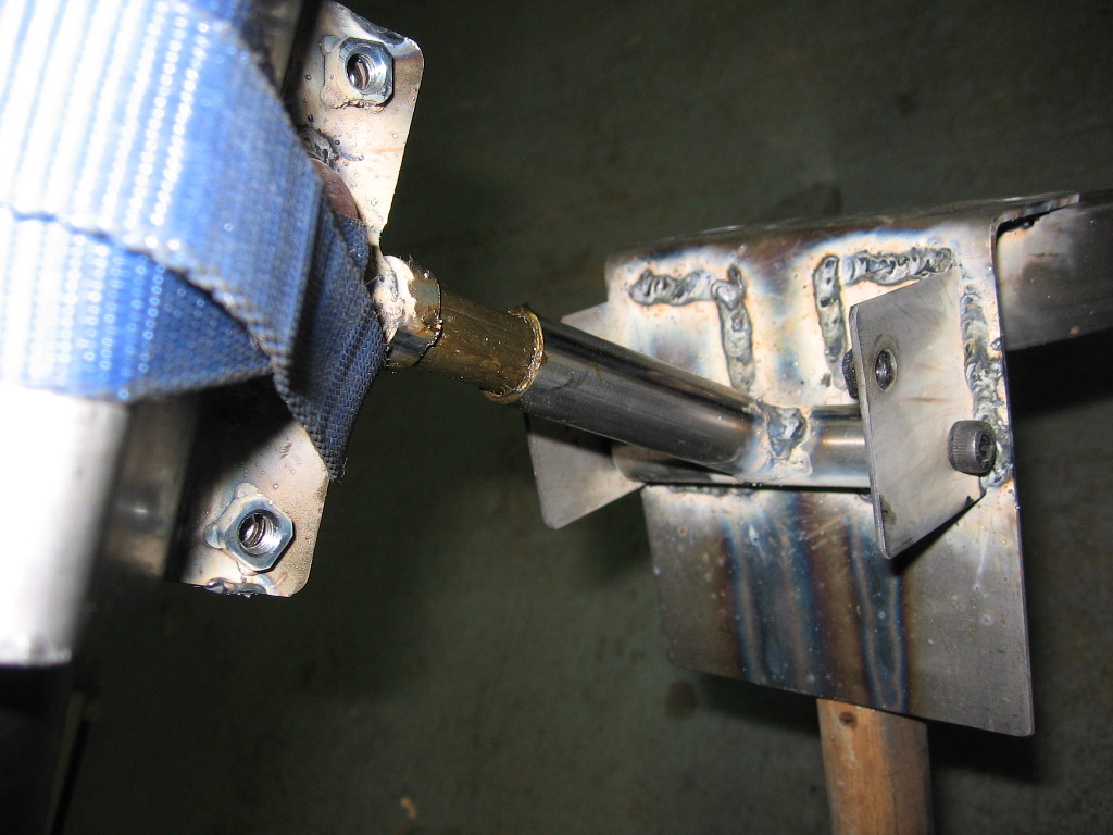

more pics and details... Read photo captions for details...
overall shot of pivot layout...
closeupof pivot, showing how the barrel lifts off.
closeup of fill/pilot... when air is connected it stops here, when you squeeze the button it fills through this valve and through the qev, when you release the button it fires.

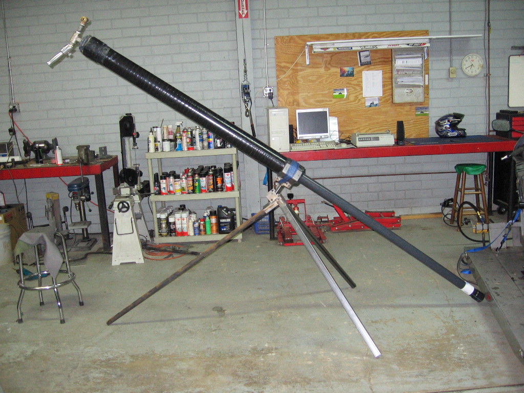

showing range of movement vertically. no need to go beyond 45 with this one..

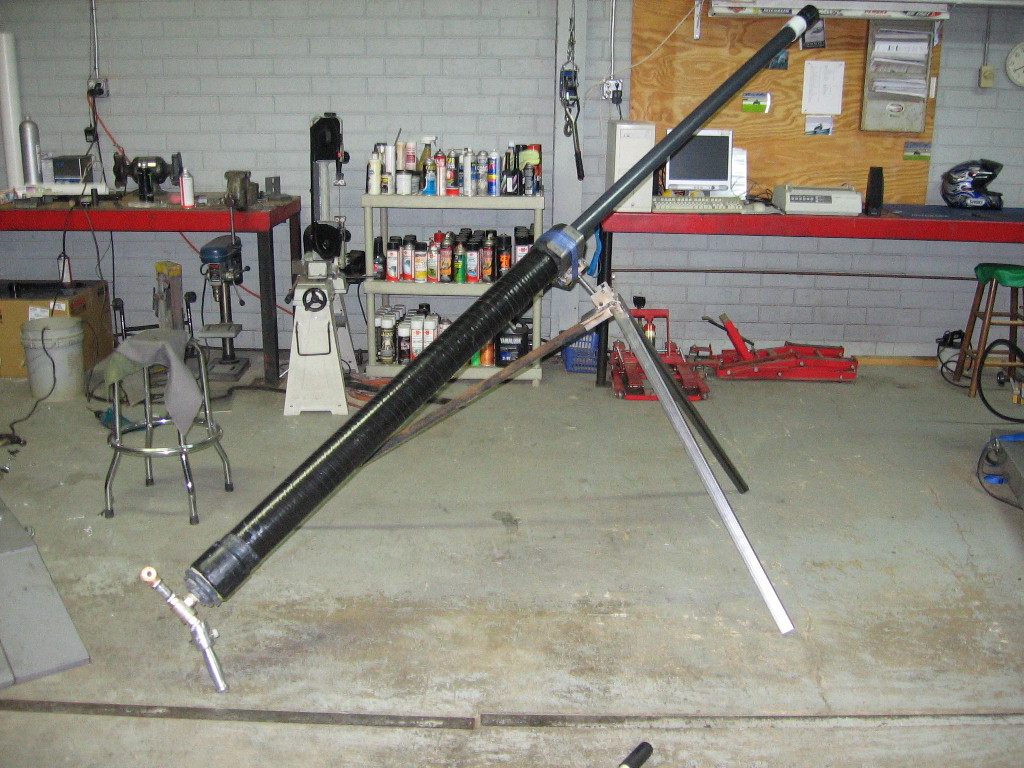

Showing range of motion vertically.

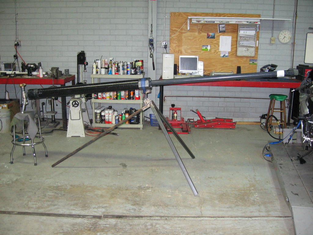

Showing 360 degree movement horizontally.

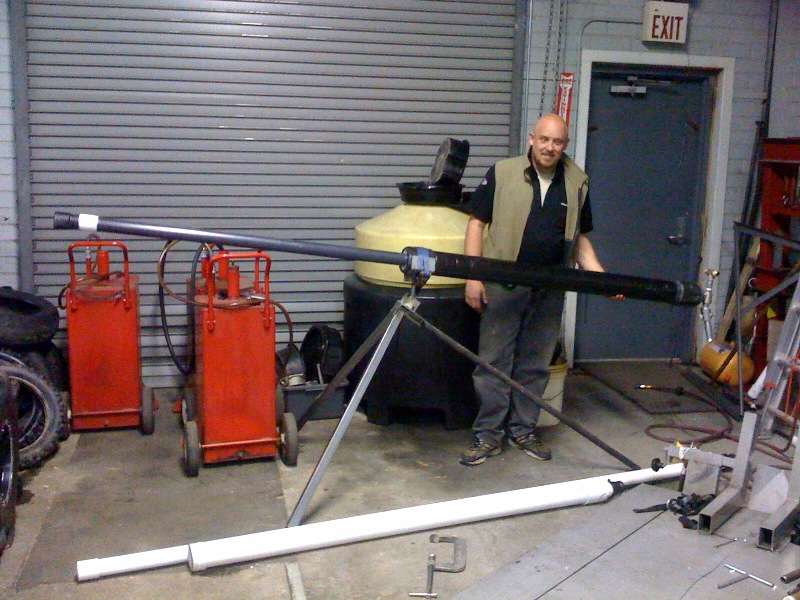

better overall pic, better lighting better camera.
