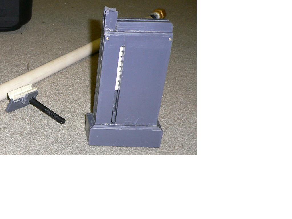

Not sure how much time you're willing to put into an actual working airsoft magazine, but I just made one that is very reliable and works everytime with a bolt action putting each bb into the breech. Here's a pic, sorry if it's hard to understand how it works- and disregard the pvc pipe in the background, that's just my barrel laying there, but the little thing i made on the left is the loader/bolt action- it slides between the channel at the top of the magazine and the bbs are spring-fed but they stop at the top while they wait for the loader to pick another one off the top of the stack. Then the bb slides up the front 45 degree angled ramp and up into the hole in the side of the barrel and the hole is sealed from air leakage with half-cylindrical shaped peice at the top of the loader. Though similar to a manufactured spring-powered airsoft gun, this is actually my own design, I made it up, works like a charm. 8) As for how to keep the magazine stationed where it is supposed to be when using the gun, I made a system for that too, but don't have pics yet, but just take apart an airsoft pistol and see how the mag-release system works, it will give you ideas.
