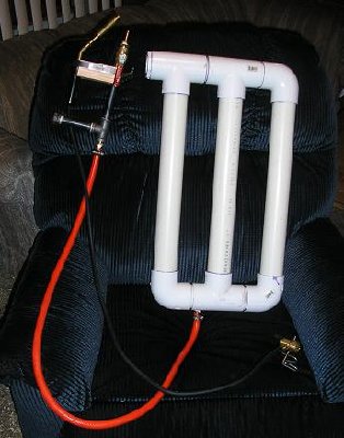

finally got around to making my new flame thrower

whats the volume in the tank?

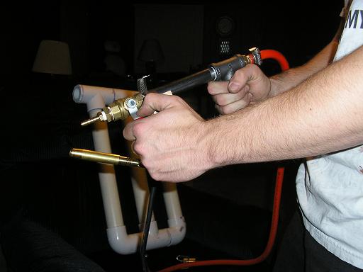

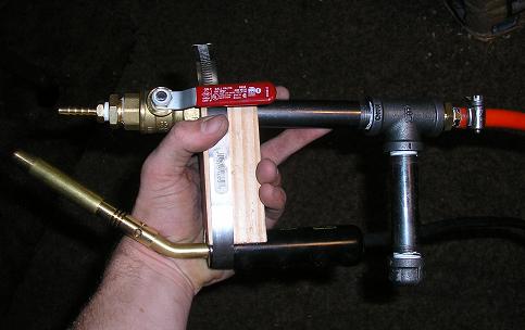

Its good to see that you havent got completly out of the hobby. Very nice indeed. I can see that the pilot fuel is propane, but what is the fuel for the flame thrower? Is the bottom leg of the tee fitting [Handle] blocked off?
I think it would have been "nicer" to of replaced the block of wood with something similar to the rear grip, but instead of having it capped, install a pipe saddle to secure the pilot torch.

a blow gun would never flow enough fuel.

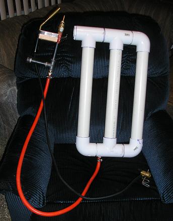

not sure on the volume but for those math types out there, the virtical pipes are 24" long and the whole thing is 22" wide
the layout is exactly the way the customer wanted it with the exeption of the tank. he wanted it to only have 2 virtical pipes and be made of 4" pvc. i said no because of the cost. 4" fittings are about 25bux each.....plus the pipe. the price in parts using a 4" chamber would have been about 300 just because of the chamber.
pimpman, not sure what you mean but if it was mine, i would have put a 90* bend where the cap is on the rear grip, and run a pipe straight forward and then capped it. to that pipe running parallel to the main body of the gun i would have clamped the torch to it. but like i said, i didnt design any of it but the chamber. and more parts means more money and the price was negotiated for a specific set up and thats what he got.
testing with water, i got a distance of 35feet. not sure on the pressure used tho because i dont have a pressure gauge on it yet. maybe 90psi or less.
the fuel ill use is gasoline for testing but he plans to use lantern fuel or paint thinner...i cant remember. before i get a bunch of people saying gasoline eats pvc, no it doesnt! back when i was active on spudtech there was someone who tested it and found that gas did not soak into pvc. i decided to soak pvc in gas to test it myself just last week. the piece of pvc has been in gas for over a week in my garage and it shows no signs of weekening or being eaten away. the piece i cut off shows no indication that gas has absorbed into it and the pvc is as strong as ever
