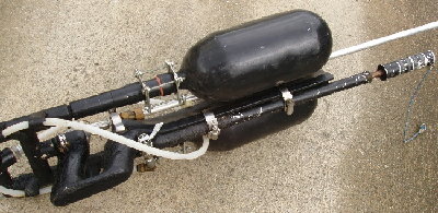

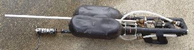

About 25 years ago I bought a blow gun (lung powered dart gun) and had a lot of fun with it. Then I had this great idea of applying high pressure air to it. Nobody I knew had thought of this or seen anything like it. I had no internet (there was probably no internet at that time) so i was on my own. Anyway this is what I came up with. Just thought id post this as an oddity. Something to make you laugh or ponder... why?
Actually I was very impressed. I could hit a notebook paper at 150 feet consistently. I would then have to pull the dart out of the back board with pliers. I don't know what air pressure I was using but I do know I was doing a lot of pumping with those huge chambers. This thing leaked like a colander too.
The barrel is breach loading (high tech stuff there eh?) and the blow gun is modified.
I intend on taking the barrel off of this thing and making a much improved all metal gun with what I've learned on spud-files.

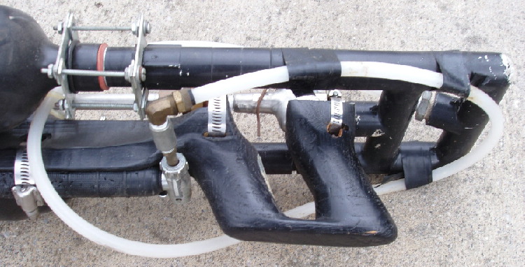

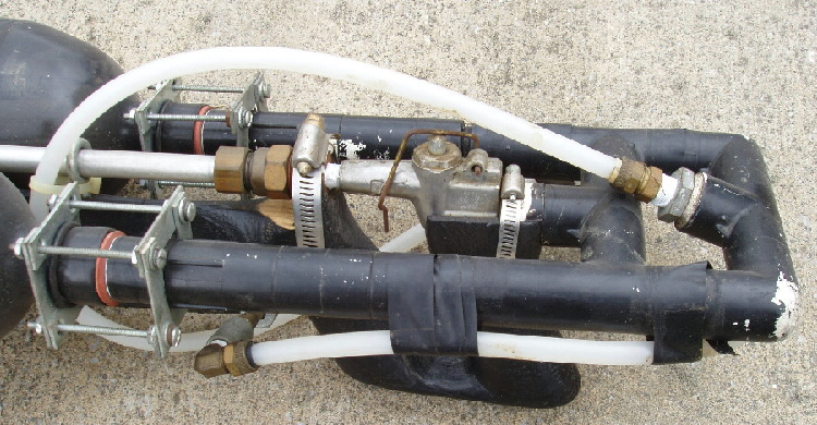

I'm not sure why I ran this tube all over the place to get to the chamber.
Note the wire trigger. Is that ghetto or what.
Wooden stock made from 2x4's
First pneumatic
First pneumatic

I am having a hard time seeing what kind of valve this thing has, what is that?

I am also curious on what kind of valve it is...

That looks like an old blowgun (not the barrel, the valve).

Yes that's just an old blowgun with the finger lever taken off.
The chambers are 2 liter pepsi bottles. They warped when I painted them. They have also been getting banged around in the shed for years.

so how well does using a blowgun for a valve work?
Worked pretty well. It was modified to allow maximum air flow. I wouldn't use it for anything larger than 40 caliber.
