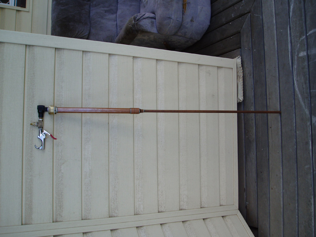

Barrel length 1085 mm with a 10.8mm bore.
chamber 400mm 23mm inside bore.
With the barrel being inside the chamber I don't know the volume and I can't work it out :? :?
Don't know the pilot volume but it aint much :)
piston it 300mm long and has a travel of 10mm.
Edit: piston is 30mm long and travels 10mm

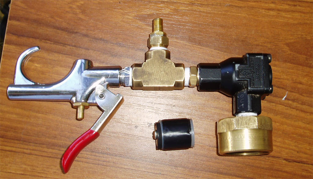

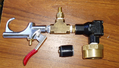

That is how my copper nightmare looks like at the moment. I wan't to bring the trigger up higher

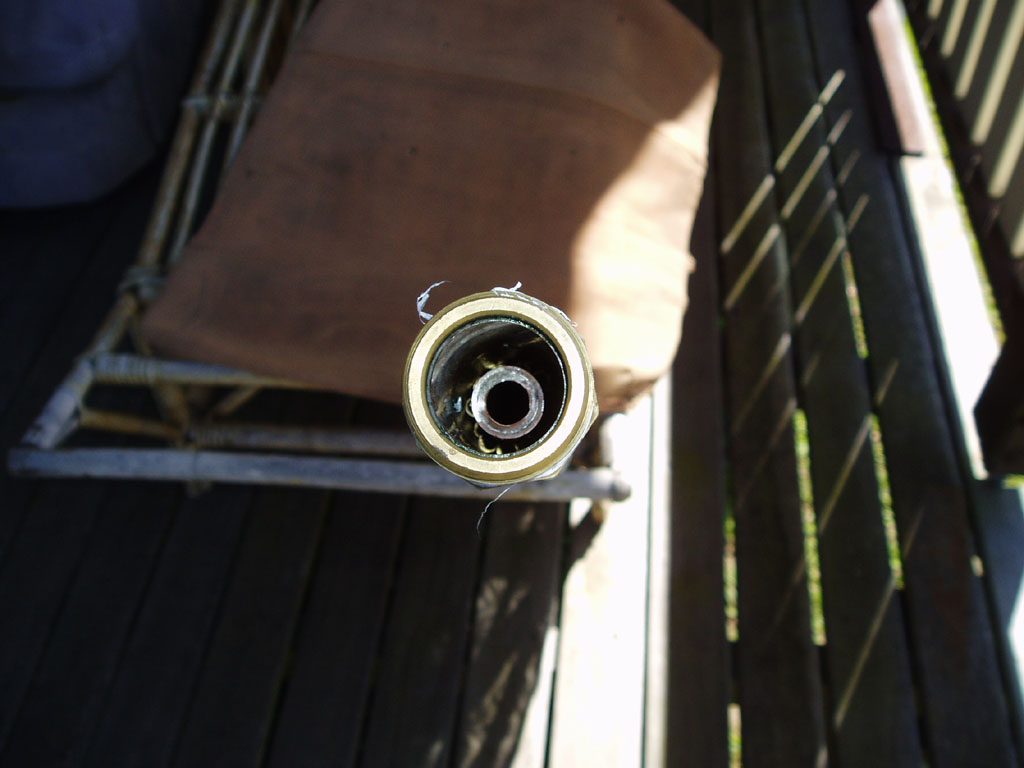

Here is a look down the chamber. I centred it using brass tubing from a hobby store. You can just see some of them

I have removed the QEV and I am piloting it from the blow gun but as soon as I try to remove the connection from the schrader valve it pilots and loses pressure.
I can't win.
I knew this was gonna be a learning experience but bugger me it is starting to get my goat :x :x

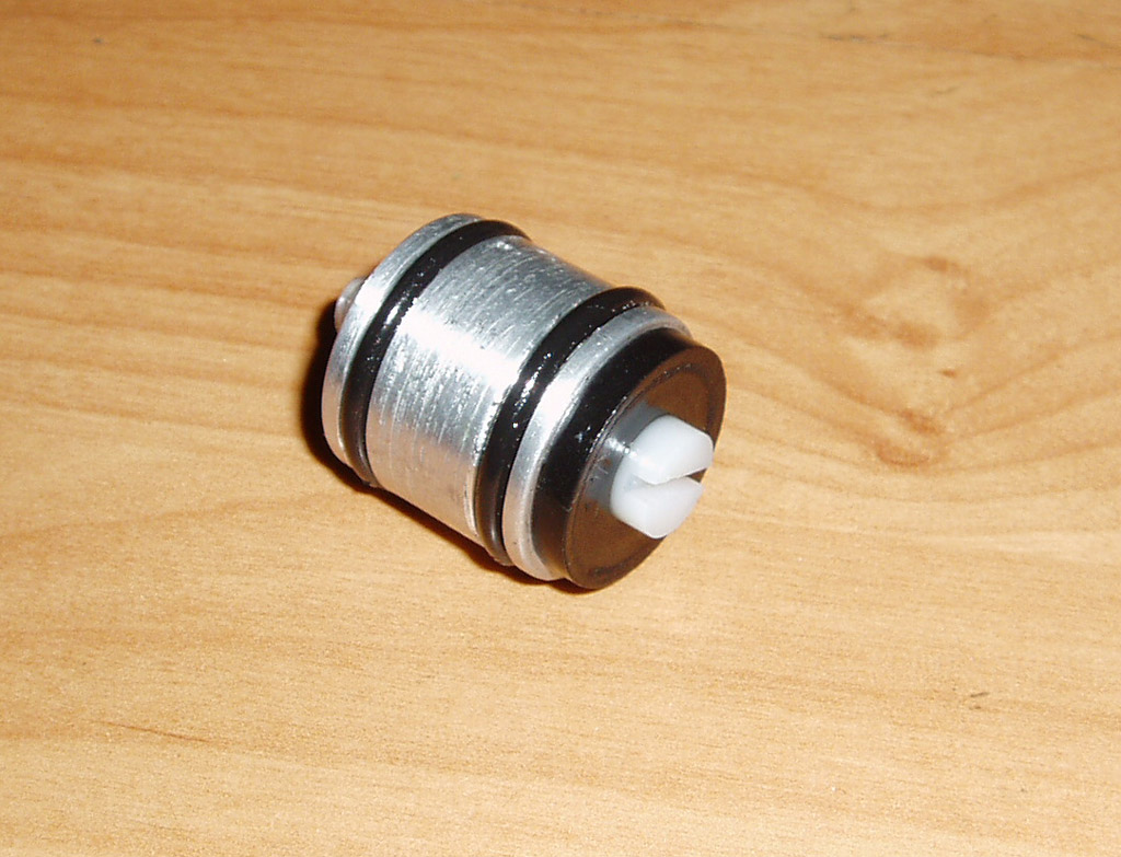

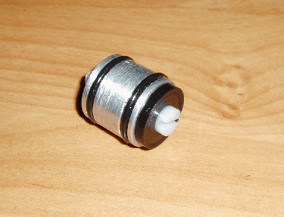

Here is the new humdinger piston of destiny.
forget about shrader valves... buy a male quick connect fitting and put it instead of the nozzle on the blowgun (it has threads right ??)... in this way you could also get rid of that T (and greatly reduce pilot volume)
ohh.... you'll need a female qc one your air source as well, but that goes without saying

Looks very good, the finish on the piston seems slightly rough but I bet it works very well with the rings!
If you don't want removing the air source to pilot your gun you could add a check valve or ball valve behind it, or use an attachment that leaks no air, such as a shock pump.
Poland, I believe blowguns are only intended to handle flow in one direction, you could try it thoguh.

Blowguns will handle flow in either direction. I've used them either way many times.
As for your piston-piloting-dilemma, I would install a check valve before the schrader valve. A schrader closes at a speed that is a function of how quickly you can disconnect it. A check valve is already closed when it comes time to unhook your air source (both the sides have equal pressure), so there's no air loss.
One can be made in a pinch, but you should be able to find a small one somewhere.
Also, that piston is looking good, but how does air equalize through or around it?

they can handle flow in both dircetions but one side will leak if pressurised...
my suggestion is to add a male qc to the other side of the blowgun (if the other port is threaded - I've never used this type of blowguns so I don't know if it's threaded)...
it would only need to hold air in one direction
mark.f wrote:Also, that piston is looking good, but how does air equalize through or around it?
Good point, I would have the piston be an exact fit and remove the o-rings alltogether - no equalistation problems and much less friction.

Floating rings work well. A calibrated bleed port in the piston is easier to adjust than piston fit.

Not only that...It keeps the piston itself from wearing and getting stuck..
Tight fit aluminium inside of a copper tube tends to get VERY stuck when it wears...
Brian the brain wrote:Not only that...It keeps the piston itself from wearing and getting stuck..
Now that you mention it, a little moisture, a little electrolyte from veggies, rancid oil, or fruit, and the resulting battery will corrode the parts together very quickly. O rings to prevent contact and provide space is highly recommended.

Sparkie wrote:With the barrel being inside the chamber I don't know the volume and I can't work it out
Calculate the volume of the chamber without barrel in it:
pi*r*r*h
r being radius (inner diameter/2), h being length of chamber
Then calculate the volume that the barrel takes up, same formula, but using the outer diameter of the barrel.
Then subtract them:
Actual chamber volume = chamber V - barrel V
Neat gun! You should indeed move up that blowgun.

POLAND_SPUD wrote:forget about shrader valves... buy a male quick connect fitting and put it instead of the nozzle on the blowgun (it has threads right ??)... in this way you could also get rid of that T (and greatly reduce pilot volume)

It never occurred to me to do that with a quick connect. Good thinking 99.

The piston is actually a plug left over from when he poured his moulds.
He melts aluminium and makes stuff with it.
The plug wasn't perfect but I am not complaining :D
Later on I will set up something for a permanent connection but at the moment I am just happy to play with it.

About the piston.....hmmmm....what can I say. only finished it yesterday arvo and I had to try it. I will be drilling an equalisation hole in it sometime but for last nights tests I cut a bit out of the o ring and it is working well.

I originally had some polyurethane rod which I wanted him to turn up for some o rings.
I didn't know he had that aluminium there till we were going to do the lathe work.
After we cleaned the aluminium up we had to use o ring and besides it looks way cooler this way :wink:
Never thought about making the bleed port adjustable.
I was going to start with a small hole and keep making it larger till it works.

I would use o ring regardless. It makes for a better seal I would think.
pi*r*r*h
Then subtract them:
