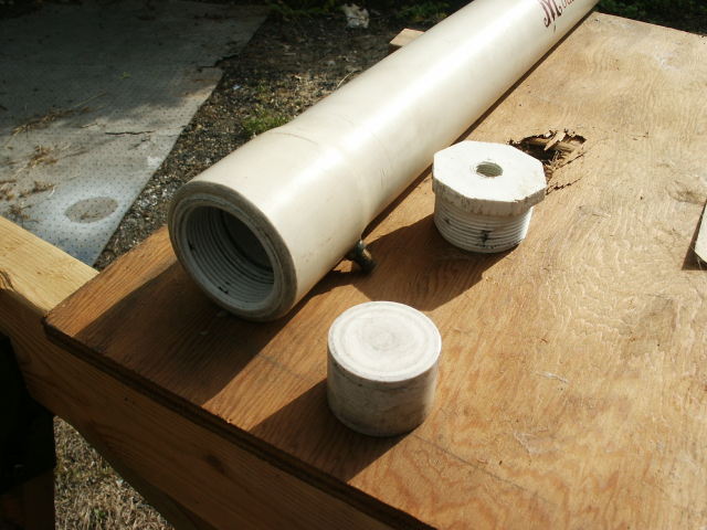

A 1 inch barrel works well with a 1 inch pipe cap turned around and sanded to fit in a 1.5 inch pipe as the valve cylinder. My Mouse musket was built this way as a coaxial instead of in a T.
Mouse Musket piston valve.<br />1 inch barrel<br />2 inch chamber<br />1 inch pipe cap for the piston.<br />1.5 inch pipe in a female adapter for the valve cylinder.
1 inch barrel
2 inch chamber
