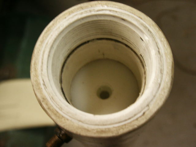

With the right size pipe in a female adaptor for the piston, it could be put in as an assembly with a removable plug. My Mouse Musket 1 inch coaxial uses this as well as my Dragon with a 2.5 inch barrel and 3 inch piston.covey12 wrote:hey guys i need to finish a piston valve by the end of this week, and from previous experiences im going to make it serviceable.
how do i do this? do i just put in the end cap and put some screws in there, how will that make it air tight,
Attached is a photo of the breech open on the Mouse Musket. This would work in a T.
