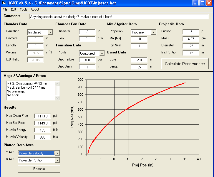

I will also try and add a picture of the HGDT simulation I created.

Do you want to bump it to 20-35x with that fridge compressor? 35x means 3500psi max. A longer barrel would dramatically improve injector performance.
The muzzle blast from the injector could possibly warm the projectile and or rails above superconducting temperature. I can't think of any strong, non conductive materials that don't get extremely brittle at LN temperatures. I vote for just dropping superconducting, since a majority of resistance comes from the ESR of the capacitors and poor contact between the projectile and rails.

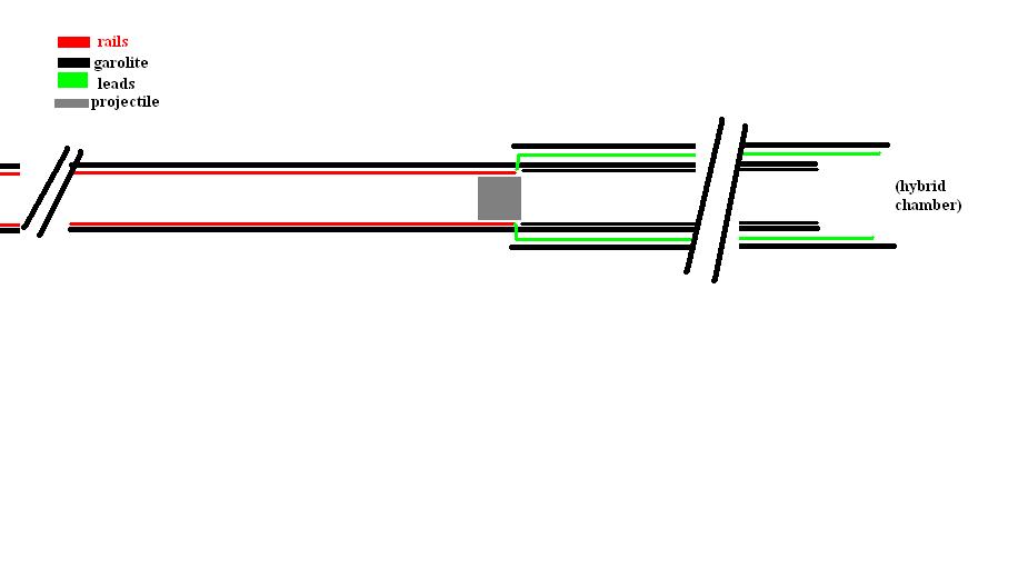

I think what I'll do is have the entire railgun be 7' long, 4' for the railgun and 3' for the injector. As per the HGDT sim, this should be able to accelerate it enough so that the railgun can bring it past the speed of sound. As for the cooling what I want to do is have the fridge compressor just pump air through a metal(probably copper) line that would have one coil in the liquid nitrogen(maybe even just dry ice) or above it, and one coil wrapped around the railgun and the hybrid chamber to avoid overheating the rails and burning myself. Here's an updated diagram.
- Design.PNG (5.52 KiB) Viewed 8845 times

I would actually recommend an inductor, to keep the first few rails from getting destroyed. IIRC, the railgun is more efficient further down the rails (away from the contact points), so get some really heavy wire and wind it around a non conductive core.
For more efficiency, you could run cables parallel to the rails along the hybrid barrel section (see pic) make sure to secure them VERY WELL. for variables, you could change injection velocity, or add external magnets to the rails.

EDIT: uploaded the pic I talked about
- railgun.JPG (24.9 KiB) Viewed 8786 times
I disagree with the inductor. The goal is to increase the action integral, which can be done by highering power, or lowering resistance and inductance, or both. Frankly, lowering the current that little is not gonna do wonders on efficiency, I have tried it with mine. Running the cable parallel backwards will help, but not much. Keep in mind that the entry part of the rails needs to be insulated, with copper underneath. This ensures that the magnetic field starts behind the rails.

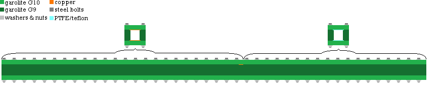

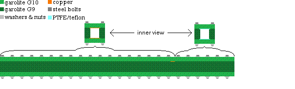

I think you guys are right I just went back through all the math and figured that I might go with a 3' or 2' gun for the cost.
But to further reduce the cost I might use electrical grade fiberglass, but anything that needs to be cut I can do at my school's shop, so no machining costs. A 6'x1/2"x3" piece of electrical grade fiberglass for Mcmaster-Carr is only $26. And it's red, that's a plus.

I figured I might as well post my bill of materials and see if anyone can see anything I might be missing(aside from materials for the charger and the flange, and stun gun, which I already have):
x1 Fiberglass sheet - http://www.mcmaster.com/#3345k44/=1ug10h
x1 Fiberglass sheet - http://www.mcmaster.com/#3345k26/=1ugmbc
x2 Copper Strips - http://www.mcmaster.com/#8964k291/=1ugdgs
x2 Teflon strips - http://www.mcmaster.com/#8545k154/=1ugdpr
x30 18-8 stainless steel bolts -
x60 washers -
x30 nuts -
x30 Capacitors - http://stores.shop.ebay.com/BCD-Parts
00ga Wire -
x? resistors
x3 Aluminum buss bars - http://www.mcmaster.com/#8975k527/=1ugqnk
8” of 3” sch80 steel pipe
x1 spark plug
x1 spark plug cap
x1 200 psi pressure gauge
x2 1000 psi valves
x1 sch120 1" steel union
x1 rerigerator compressor

oh my god. Why so much material? The first 4 items is more than twice what i spent. With that kind of materials, you should just buy my enclosure =)
Everything does look good though. If you have the money for that kind of stuff, ditch the injector, buy a SCR assembly.
How come everyone can find things cheaper than I can? How much did you spend the materials for your gun, if you care to remember and break it down? If anyone knows where I can get anything for less, do let me know, I would appreciate it very much.
I think your buss bars could be a little wider. also, for the caps, you just linked to the BCD parts Ebay store, not the actual caps.
the caps I used (2400uf, 450v, 525v surge) have held up fine discharging short circuit, through inductive loads (with a massive clamping diode). I can't say that pulse caps wouldn't be nice, but the price per joule is so much higher. this guy is using similar 'lytics with fair success. a 24kj bank, in fact.
mounting the sparkplug will be a PITA. I was going to tap a 3/8" NPT hole in a bushing, but I decided the wall would be too thin, so I filed off the threads on the sparkplug, the dremeled threads on the bushing, and JB welded it together. so far, it has held to 5x 3 times.
do you have parts for the fuel meter? Enclosure for the caps (I put mine in a box from a case of wine)? Materials for the projectiles?
I used mcmaster mainly, but got different capacitors (BCD ones are a better deal). Why do you need so much fiberglass and teflon?
