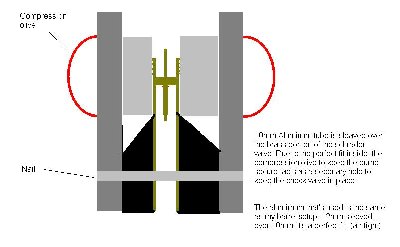

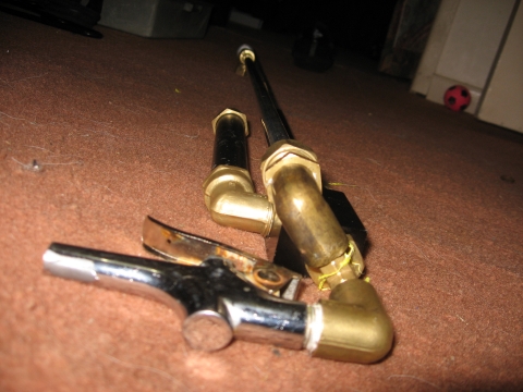

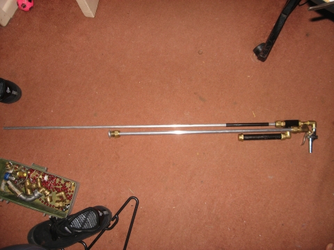

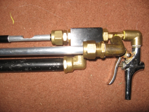

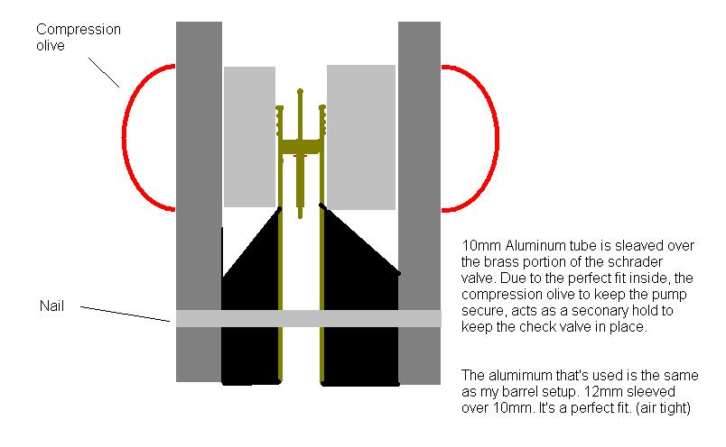

This is my new proof-of-concept gun. It's a simple throw together. The pump I'm extremely happy with and the performance is just awesome.
Just to give an idea of the pump, the barrel is a meter long so it takes no time at all to get very high pressure. I plan to do a final copy tomorrow and take down the chamber even further.

Sweet! looks good but the pump will need reenforcement i assume.

Yeah that will come with tomorrow's final production. I'm glad I used aluminum over copper. It's just so ridged. It doesn't bend what so ever. Perfect application I think.

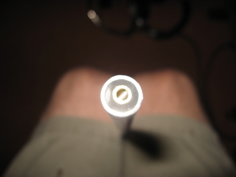

I have to ask, what is going on with that picture that Jack linked? I just dont get it...
jook13 wrote:I have to ask, what is going on with that picture that Jack linked? I just dont get it...
I'm guessing he's holding the pump element between his thighs in order to take a photo of the end - either that or he has a substantial RoboCock<sup>TM</sup> :)

Jack you dirty minded person :D. That photo was so hard to take, it was the best one. In the other pics, I was naked trying to hold it with my old fella so count yourself lucky (am I kidding or not? :lol: )
