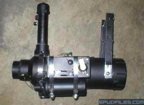

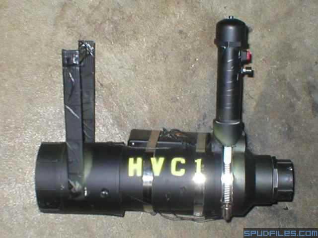

I think it best to show you my version of the chamber before explaining the wiring and such, so below left is a picture of the HVC1 ( H high V voltage C chamber Version 1 ) fully put together, and right, a close-up of the project box and coil.
<img src="http://www.spudfiles.com/official_pics/ignitionleft.jpg">
<img src="http://www.spudfiles.com/official_pics/ ... gniter.jpg">
The circuit board fits nicely into a 2" x 2.5" x 5" project box. The project box and coil can be strapped to the chamber using pipe straps or whatever you want to use. On the project box I have a key switch (Main power), a pushbutton (Safety discharge), and a AA battery holder. On the handle I have 2 pushbuttons (Charge and trigger).

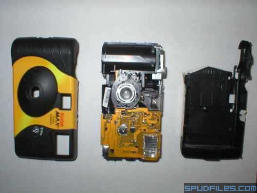

OK, I think we can now take a look at the circuit board. So go ahead and open up one of your cameras (On Kodak Max cameras there should be a little clamp thing on the side opposite where the film goes, you can open it up with a screw driver). Be very careful not to touch the circuit board and especially the capacitor!!! If you do you run the risk of getting one hell of a shock. The camera may need a little gentle persuasion to get the case off. However, once it's off it should look something like this.
<img src="http://www.spudfiles.com/official_pics/INSIDECAM.jpg">

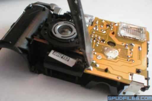

The circuit board colour may be different but all the connections are pretty much the same. Once you have the case taken off, the first thing you will want to do is remove the battery and discharge the capacitor. The battery is on the underside and you should have no problem removing this. The capacitor needs to be discharged so you don't shock yourself while you're working. Take a screw driver, pliers, anything metal with a plastic or rubber handle and touch it to the two terminals. The whole idea is to short out the capacitor so there is no charge to shock you. When you short out the capacitor there will be a big spark.
<img src="http://www.spudfiles.com/official_pics/CAPDIS.jpg">

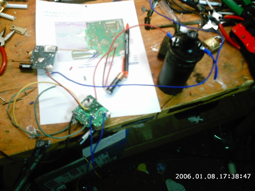

<img src="http://www.spudfiles.com/official_pics/HVCPCBMAP.jpg">
As you can see this can become quite confusing... But I would start out by soldering appropriate lengths of wire onto your buttons and switches and planning out where they all will go. Once you have that all figured out drill your holes in your project box and wherever else you need to. stick the wires through in appropriate order and eventually into the box. Now comes the annoying part. Solder all the wires to their appropriate contacts. Once everything is all soldered in, test it just to make sure everything is working ok before you close it up. Once you have it working properly, close it up and strap the coil and box on however you want. Pipe straps are always good but you could use anything that will hold good and tight.
As you can see the spark from this system is big. very big.
<img src="http://www.spudfiles.com/official_pics/ ... nright.jpg">
<img src="http://www.spudfiles.com/official_pics/bigspark.jpg">
Unfortunately this system can be somewhat unreliable. Since the capacitor needs to charge to fire, pressing the trigger too early is a common problem. Also shorts in the wiring are a problem. Overall, when this system works, it works very well. However, when it doesn't work, it is annoying and takes some time to figure out what's wrong. I would recommend this system before moving up to stun gun ignition, but not for use as your main chamber.

I found a camera like this one, and i cant figure out where to make the connections, i'v found where to put the trigger only. I'v tried to connect the charger button, but i think i'v connected it wrong, since my capacitor wont charage. And the beatery is getting extremly hot.
Could you show me where to connect on the camera i have?
Cool
Posts: 26
Joined: Tue May 03, 2005 6:46 pm
Sat May 07, 2005 7:13 pm
I got it to work now :D didnt have to add any wires except the wires to the coil.
I'v found out that if i have a button for the batery, so i can turn it on/off, and a button to the + pole on the coil, its much more easy. Just turn the batery on, wait a few seconds, and then turn the switch to the coil on, and ZzZapPp.

Ok i dont get this your gun uses two leads that go into the chamber and this guy uses three leads http://www.angelfire.com/80s/sixmhz/camera.html . How did you do yours? Is it the same wiring or is it different wiring. IM CONFUSED :? !
Edit: There is two wires from the flash tube then one from the flash tube reflector. Did you connect two, leave one out, or run a wire twice? Or am wrong all the way around. Im so confused.
saladtossser
Posts: 1234
Location: Toronto
Wed Jul 13, 2005 8:26 pm
i think the middle is the ground
