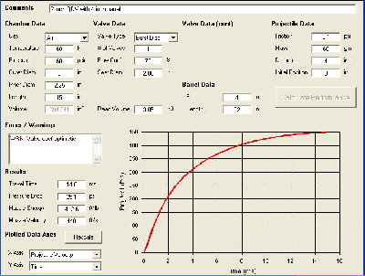

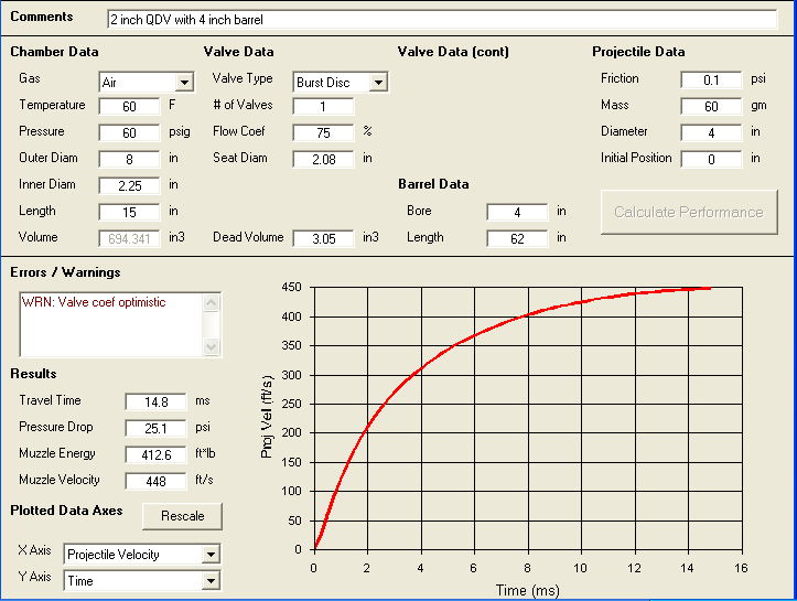

For fun, here is a graph of a 2 inch valve with a little larger tank and barrel, just to show the flow you can get through a larger valve. The projectile is a 4 inch foam Poof brand ball.
