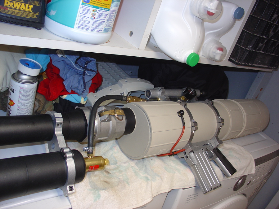

In the picture of the Bl-520 the chamber looks at least 20 inches. yet this is way too big for the ideal volume. Is it the metered injection, blocked off part of the chamber???????????????. The tests show that to big of a chamber will have a drastic reduction in velocity of the spud. Whats the deal???

This is a COAX so part of the chamber is occupied with the barrel.joe blogs wrote:I have been wanting to make the bl-520 rear loaded cannon for some time now and that lead me to chamber:barrel ratio's. Below are the calculations for a

Yes, and seen as the barrel is two inches in diameter the volume is significant.

To calculate the chamber, use GGDT as it has a formula for a coaxial chamber. The hole in the gas due to the space occupied by the barrel is the inner diameter. For 2 inch pipe it is 2.375 inches. Dimension found here;inonickname wrote:Yes, and seen as the barrel is two inches in diameter the volume is significant.

I sort of did factor in the barrel occoping space. Though i didnt factor in the OD i did factor in the ID which wouldnt make that much difference. This is why the formula
is done. If you read properly you will see that i know its a coax. Granted that i have my formulas right what occupies the other space?. This is the formula for a Coax with a 30 inch chamber.
30 inch long 5 inch chamber
30 x pi x 2.5^2 - 30 x pi x 1^2
---------------------------------- = 2.625 ratio
60 x pi x 1^2
This is how long some of the coax's and even over under cannons chambers look. The reason i am asking this question is that i want to build a coax with a decent chamber length so that it holds like a rocket launcher. a coax with a 8 inch chamber length (ideal) does not hold right. Are all these long chambered cannons sacrificing power for length or is there something else? Are the ratio's right?

Does the fan assembly in the bl-520 take up much volume? I plan on making this cannon.
But the fan assembly on the bl-520 looks like this.
I hope to understand this as i dont have a clue about my ratio problem. Maybe i could internally partition off the chamber so a 20" chamber would act like a 8" chamber.

Joe,
Internally our chamber runs a total of 22". With deductions of barrel and vent piping, fan, etc our chamber ends up at 298 cubic inches. Barrel length measures 62 before brake openings and equates to 195 cubic inches. So we are at 1.5 chamber to 1 barrel ratio. All of our assembled 520's come with take down barrel assembly, so longer barrels / GB barrels and lower C:B ratios are a swap away.
We have found our customers prefer this ratio due to report.
Make sure to run your vent tube to the bottom to help evacuate the deoxygenated between rounds.
Good luck, look forward to seeing your launcher.

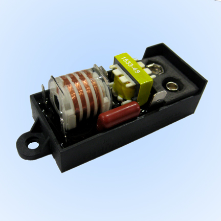

No need to remove. We do offer a low cost ignition module http://ultimatespudgun.com/product_info ... cts_id=219The ignition would be a HV source such as a stungun (of course he didn't just attach a stungun to it). (Jager, as you are a sponsor of the site I can remove this info if you want for your marketing interest..)
Mike
Sureshot / http://www.ultimatespudgun.com
Cute lil thing ^^
It looks like it works exactly like a stungun circuit with a questionmark hovering over the low voltage switching method.
